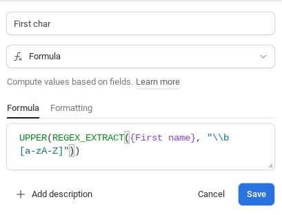

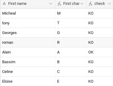

Hello,
I have a table with fields like this :
The "First char" field is a formula that return the first character UPPER of the "First name" field.
Then, the field "check" is used to filter a view from A to E. So i need a formula that show "OK" if the "First char" field contain A or B or C,,,,,,,,,E or else it will show "KO"
Any ideas how to do it ?
Thanks.
Best answer by AirOps
Hi @Slim_BENAZIZA
try this formula:
IF(ISERROR(REGEX_EXTRACT({First char},"[A B C D E]"))=1, "KO", "OK")
I hope this helps!
AirOps

Thank you so much !
Yes ! this solve my problem. And this formula works.
