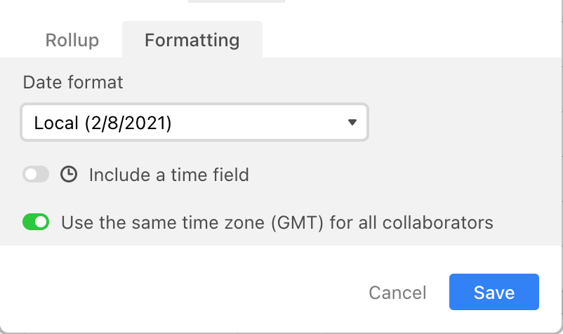

Hi @Katie_Kline,
On the Formula field that is returning the date as 1-day behind (and only on that field), select the “Formatting” tab in the field options menu and enable the “Use the same time zone…” option. This usually fixes the problem by forcing the Formula field to use the same time-zone as the originating Date field (even though the language in that option doesn’t seem like it would).

That did the trick. Thanks very much!!!
