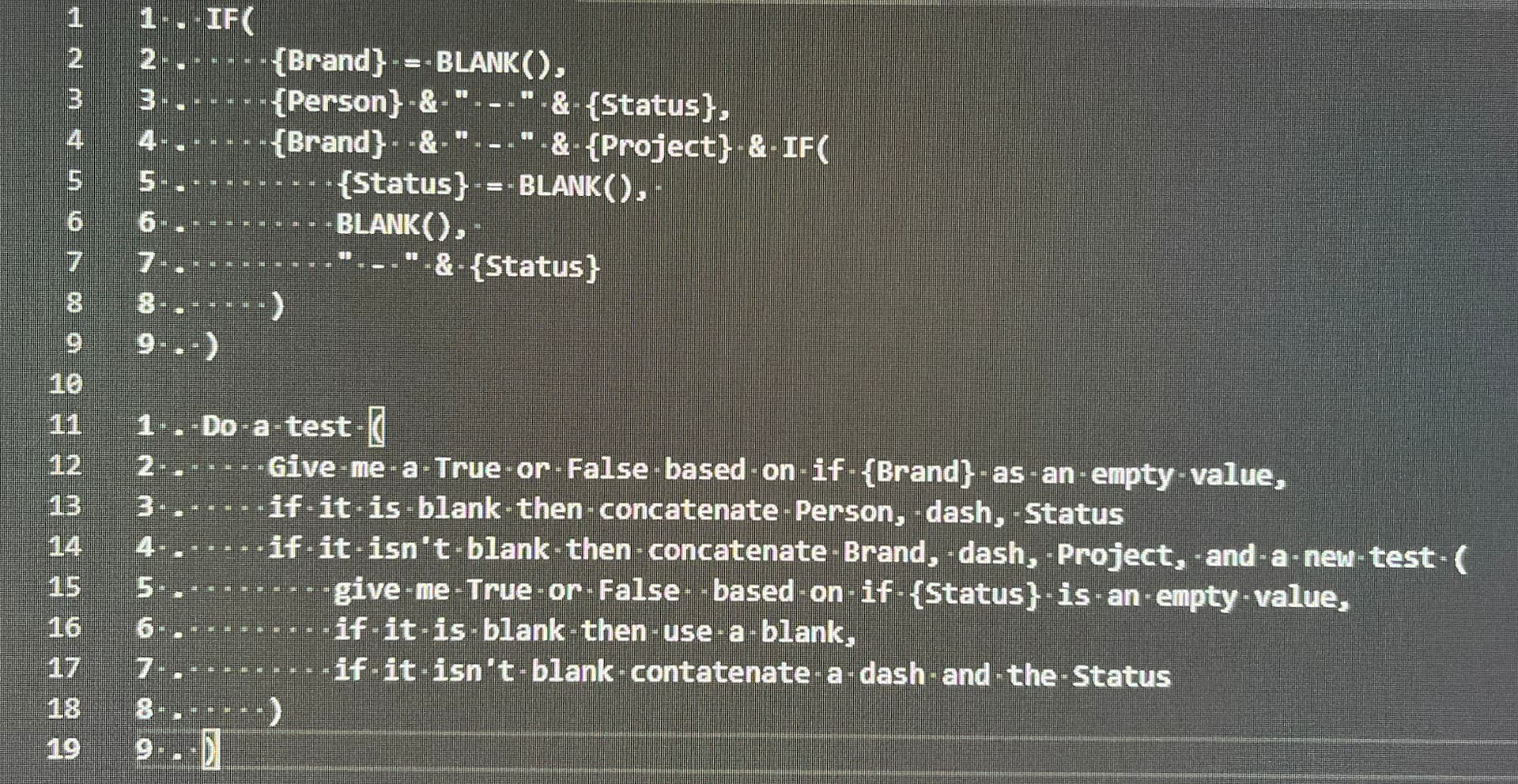

Best answer by Betsy_DeWitt
I’d love to take full credit for this but I had IRL help to get the formula to work. Nevertheless the solution:
    {Brand} = BLANK(),
    {Person} & " - " & {Status},
    {Brand}  & " - " & {Project} & IF({Status} = BLANK(), "", " - " & {Status})
(attaching a picture also of how the setup was explained to me)
    {Brand} = BLANK(),
It also seems to work as simply as this (assumes brand and project operate as a pair in that they are both full or both empty
{Brand} & " " & {Project} & {Person} & " - " & {Status}
thanks for the help @augmented I appreciate the response
