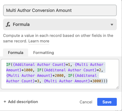

Hello all!
I am trying to compile a formula that dynamically spits out a value based on the values in 2 other static data fields, the first being an Additional Authors Count that counts the number of authors that exist on a record and the second field being a deliverable field. The end goal of this formula is to compute a number amount that a freelancer should get paid based on completely specific deliverables and taking into account the number of authors on said project they worked on. For example: If a freelancer works on a project deliverable of content calls and they do so on a project with an author count of 2 additional authors, I want the formula to be able to spit out a number based on those two external values and the static values that live in said formula.
I’ve been able to get this far, but now need to somehow add in the deliverable field condition so that if the deliverable is Content Calls and Additional Author is 1 then add 1000 to the existing multi author amount (which is a sperate stand alone field that also exist in the table) and that will be the value housed in this formula field at the end for 9 different instances (see conditions listed below). Right now I have the following:
ALT Text: IF({Additonal Author Count}=1, {Multi Author Amount}+1000, IF({Additonal Author Count}=2, {Multi Author Amount}+2000, IF({Additonal Author Count}=3, {Multi Author Amount}+3000)))

Your translation doesn’t appear to have the value of {Deliverable} affect the outcome, which seems to be just (1000 * {Additional Author Count}) + {Multi Author Amount}. So try that formula to start with.
If you do need to have the Deliverable field factored in there somehow, SWITCH Is definitely the way to go.
