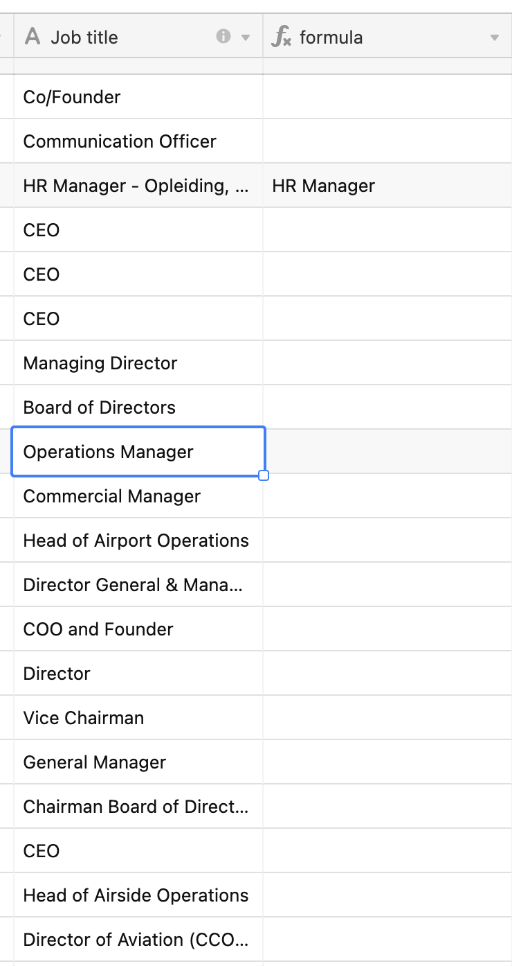

Hey guys,
Can you please suggest to me a formula that will remove a text after multiple characters ( ‘’,‘’ ‘’/‘’ ‘’ - ‘’ ‘‘and’’ ‘’&‘’ ‘’;‘’ ‘’(‘’.
I already found on this Forum the formula that removes a text after one single character,
LEFT(
{Column name},
FIND(
{Column name}
)-1
Can you please advise me on how to add to this formula options for other characters, or maybe the new formula that will have a such workflow, thanks in advance :slightly_smiling_face:

@Nathaniel_Granor thank you very much for your advice, but I don’t need just to extract those characters I also need to extract the text after those characters:
COO and Director - COO
COO/Director - COO
COO - Director - COO
COO, Director - COO

Woow, thank you very much, it works :pray:
