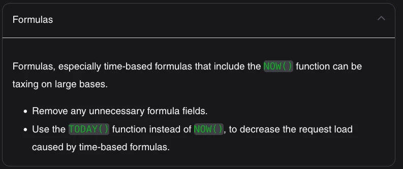

re: Is TODAY just as much of a process hog? If TODAY isn’t the same calendar day as the event record yet, I’d prefer to be able to say IF(IS_BEFORE(TODAY, {End}), FALSE(), {{ existing formula}}), so that NOW is only in use when checking the time on the day of.
According to the docs TODAY’s better?  Not sure how much better tho
https://support.airtable.com/docs/troubleshooting-airtable-performance?utm_source=forethought-chat#can-i-resolve-or-prevent-base-performance-issues
