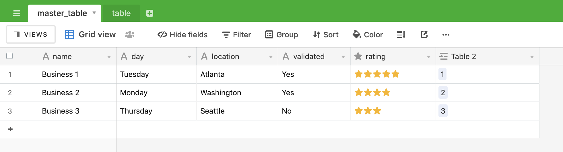

To be clear (in case I’m doing something obvious wrong which I think I must be) here is a simplified example of ‘master table’:

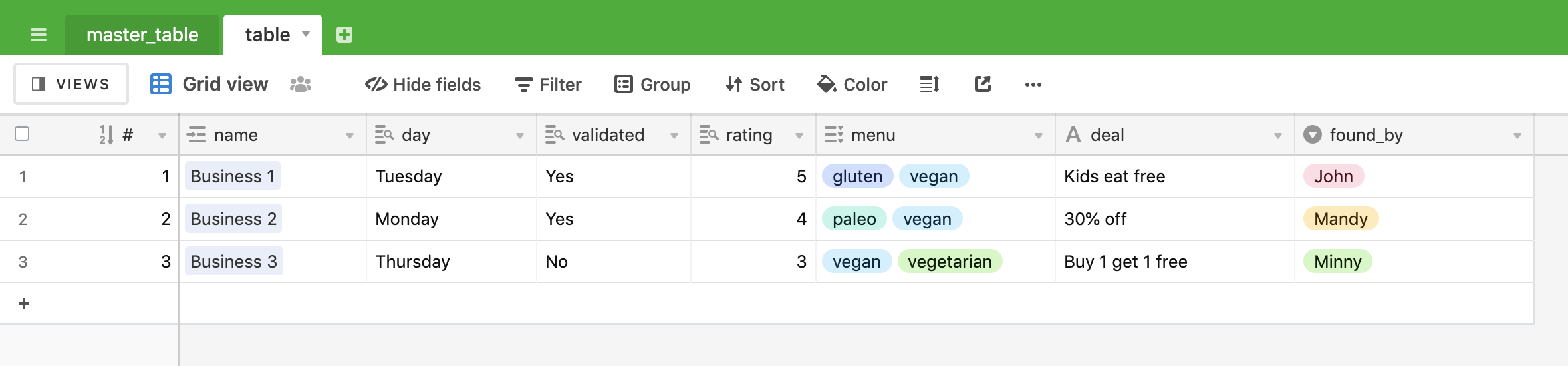

Here is a simplified example of ‘table’ that links to the master table. It has a linked field, some lookup fields and some unique fields of its own. I’m wanting to access all these values to populate my components.

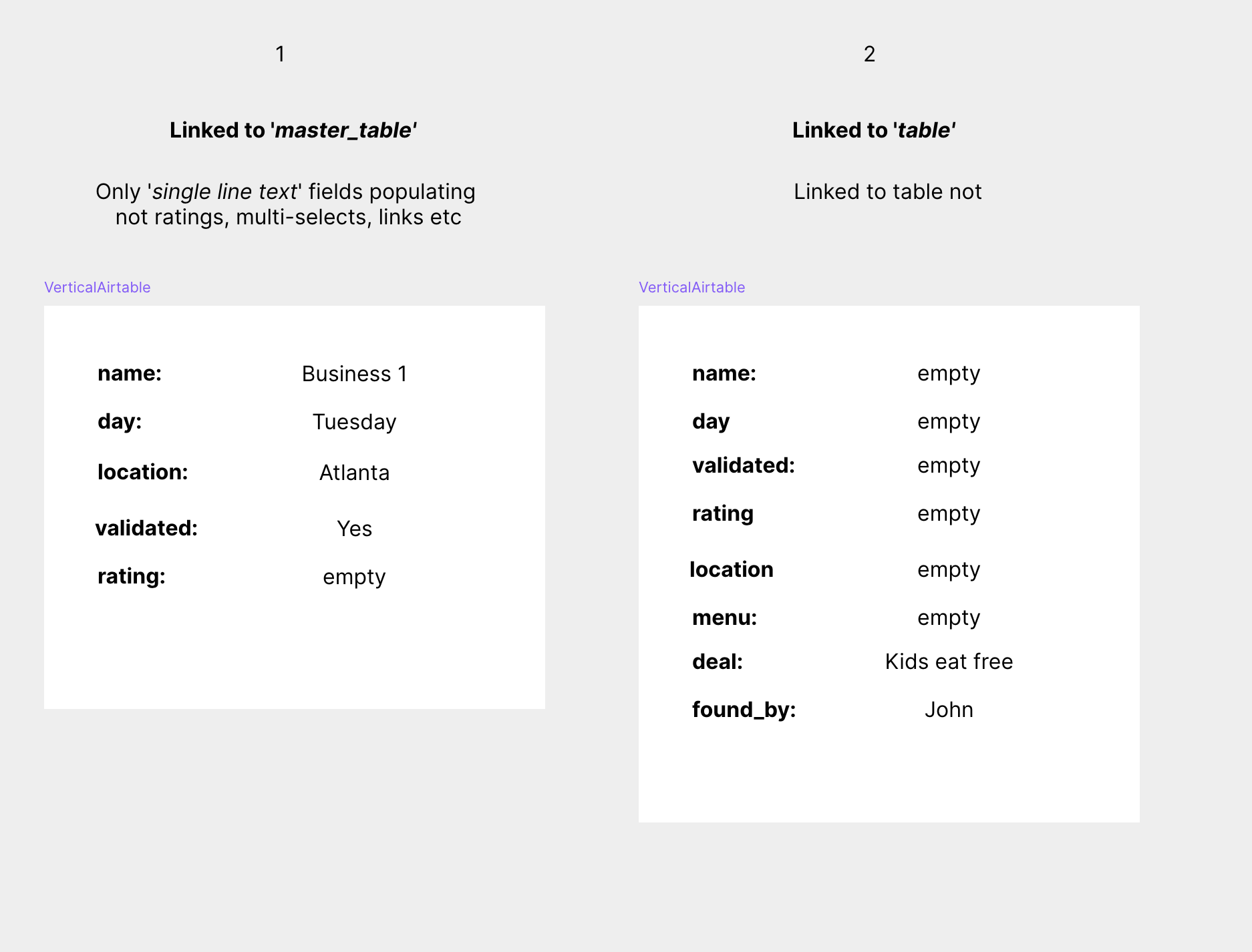

Heres also which fields are/aren’t populating some demo components:
