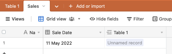

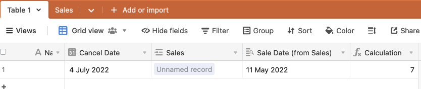

Hey Peta, hmm that looks right. Could you provide a screenshot of the relevant tables / fields so that I could troubleshoot it perhaps?
In the meantime, I’ve set something up here for you that you can use to compare against your own base

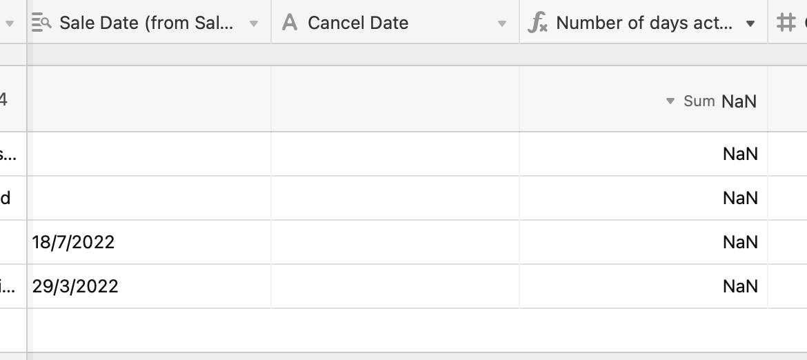

Thanks so much for your help Adam. Here are 2 screen shots
Hey Peta, it looks like the Cancel Date field is a Single Line Text field; could you try changing it into a Date field?

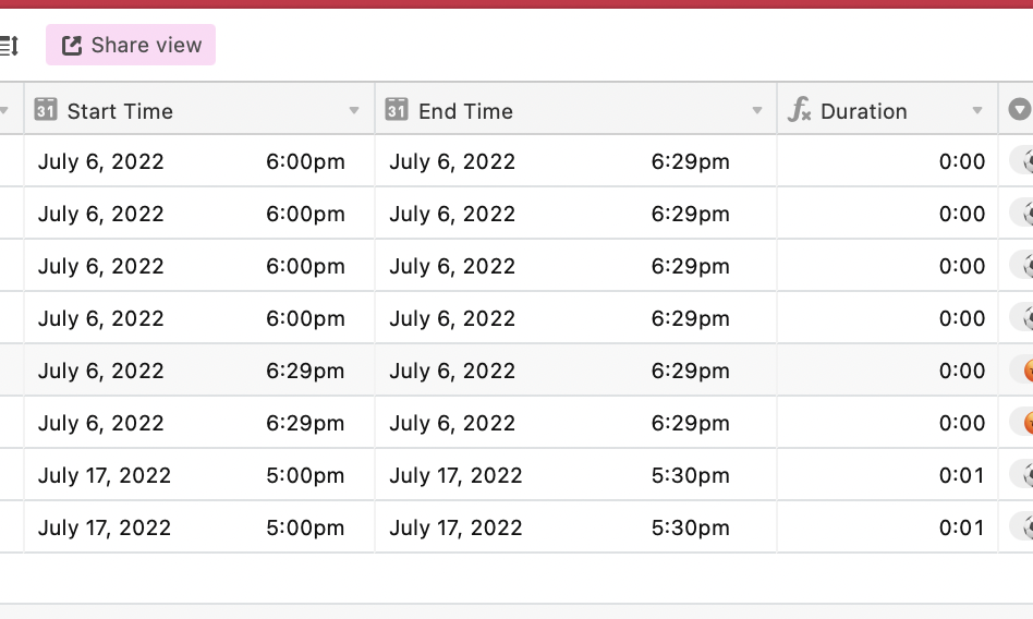

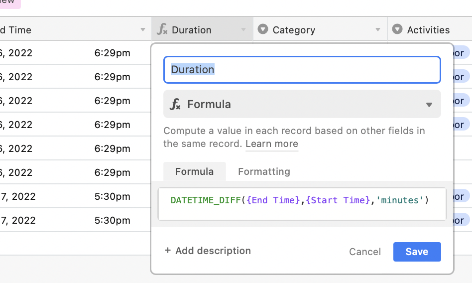

@Adam_TheTimeSavingCo Hi Adam, could you also check my formula? I’m having the same problem as @Peta_Howlett but both fields, in my case, are already in Date format.

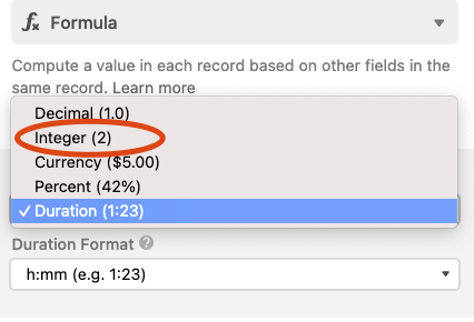

Hi Anita, your problem’s probably to do with the formatting of the Duration field I reckon
Try setting it to Integer instead of Duration
Thanks so much for your help. It worked!
