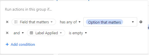

  4. Now create a Conditional Action in the automation
  5. Fill in the condition like this:

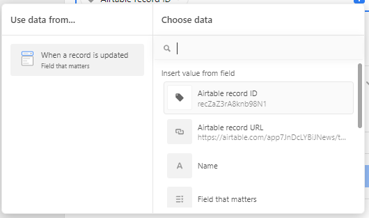

  7. For the record ID to modify choose the “Airtable record ID” from the “When a record is updated” trigger

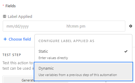

  8. Add the “Label Applied” field to the list of fields to update and change it to a Dynamic value

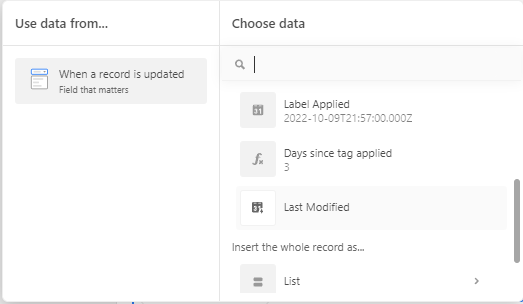

  9. Select the “Last Modified” field from the “When a record is updated” trigger:

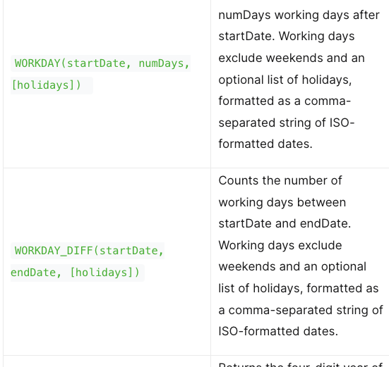

Your formula was exactly what I needed! Thank you for that. I’m wondering if you know how to incorporate Workday_Diff into it so it only counts workdays in the total, not weekends. I’ve been struggling to make your formula work with Workday_Diff, but I’m also not very good with formulas. :grimacing:
Here is a screenshot of the Airtable formula I want to make work with yours:

hmm… what have you tried? What problem are you running into?
