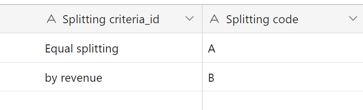

-1- Table "Splitting criteria"
I added a field "Splitting code" with value A or B

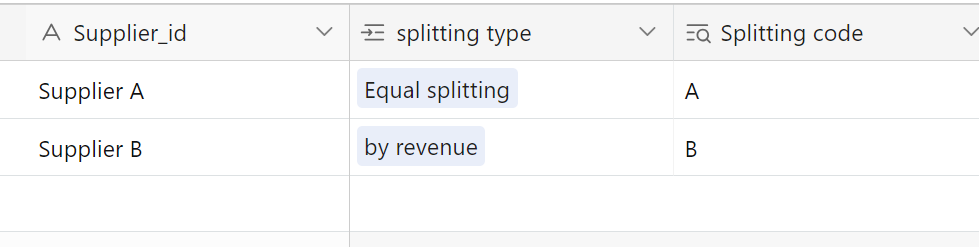

-2- Table supplier
Linked to table "Splitting criteria" via the field "splitting type" and with a lookup to get the "splitting code"

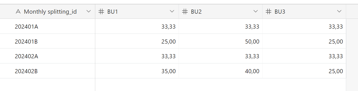

-3- Table Monthly splitting
2 rows for each month with the primary field being "YYYYMM" with the code A for the first row and the code B for the second row
You then set values to 33,33 for all "A rows" and set the expected values for all "B rows"

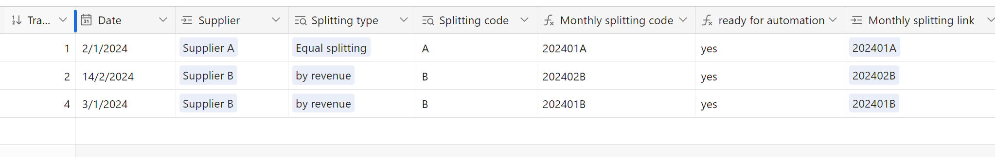

-4- Table Transfer
Link it to table supplier and add 2 lookup fields to get the "splitting type" and "splitting code"
Add a formula to build the "Monthly splitting code":
DATETIME_FORMAT(Date,'YYYYMM') & {Splitting code}
Add a formula "ready for automation":
IF(LEN({Monthly splitting code})=7,'yes','no')
This is because we will create 2 automations to get the link with table "Monthly splitting", but we want to make sure that it does not run as long as all required information has not yet been provided.
Add a field "Monthly splitting link" linked to table "Monthly splitting" and 3 lookup fields for the % of each BU.

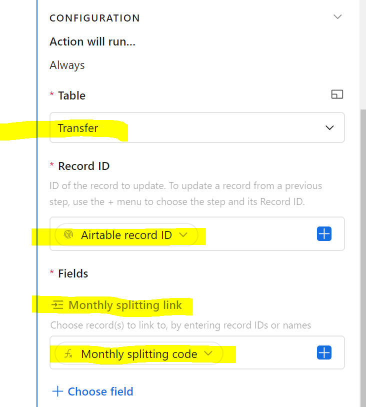

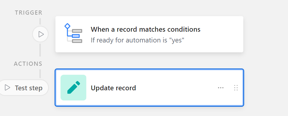

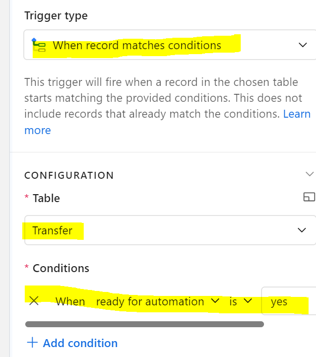

-5- Automation "create transfer"
This one deals with the case when a record is created into table transfer:
Trigger:
Action "Update record":
Once this automation is truned on, any new row in table transfer will be automatically linked to table "monthly splitting" and hence bring down the % per BU.

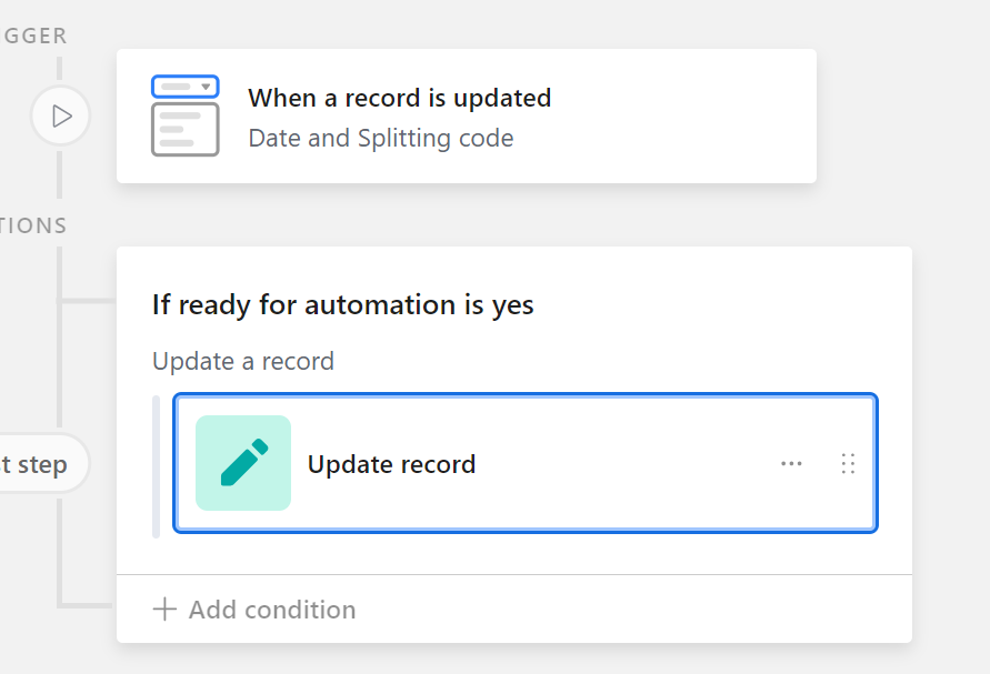

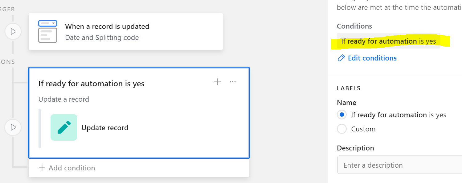

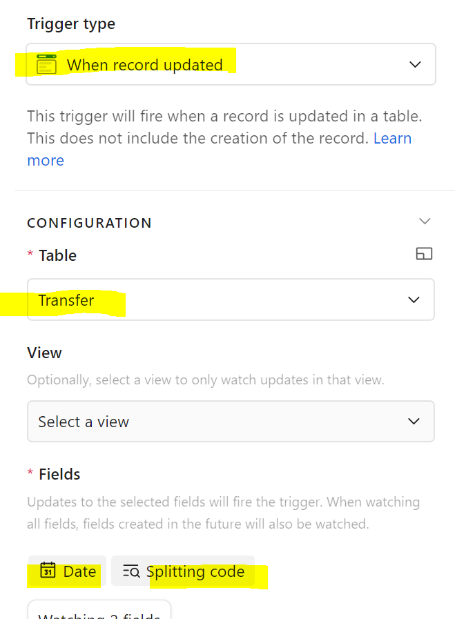

-6- Automation "Update transfer"
This one deals with the case of an existing row being modified in table transfer:
Trigger:
Add a "conditionnal logic action" with the same "Update action inside":
This condition is important to deal with the different cases:
- Supplier's splitting criteria is modified, automation runs
- Date is modified, automation runs
- Date or supplier fields values are deleted, automation does not run. But the automation "Create transfer" will run when the information is provided.
