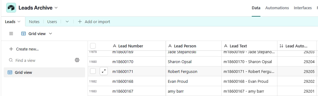

I think I have painted myself into a corner here. Appreciate any advice.
We’ve migrated from another system that generated autonumbers for our Leads.
I’ve imported all the  leads them into my Leads table. It is critical I keep the old data - it can’t be changed as all our  work for these clients has been against that specific ID number.
You can see from my Screenshot that column A has the ID number (now a text field), column B has the customer name, and column C is a joining of the two (but just a text field for now, no formula/concatenation used).
I have tossed in a 4th autonumber column to try and create a formula that carries on the numbering from column A (Lead Number). But now I’m stumped. Having an ‘m’ at the beginning of the Lead number does not help - otherwise I presume a simple sum formula to add the lead number to the autonumber would suffice.
It’s like I need historical numbers to be text, but all future records to be a formula.
Any ideas? Thanks in advance.

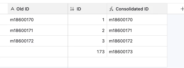

Try:
  1. Create a new formula field that’ll output the correct autonumber ID for the next record you create
    1. Probably going to have to deduct a number from your current ID given that your current autonumber is 29k and you basically need to hit 172?
  2.  Use a formula to combine the ‘m186’ bit with that ID, and use a REPT to add in the zeros
I’ve set something up here for you to check out, and here’s the formula I used:
{Old ID},
{Old ID},
'm186' &
REPT(
'0',
5 - LEN(ID & '')
ID
This system will fail once you hit 5 digits of autonumbers though, if that’s a concern then you’d attempt to get the ID to match 600172 instead of 172, which would give you 6 digits instead, etc etc
Hit me up if you could use some help setting it up
