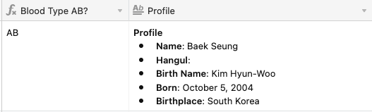

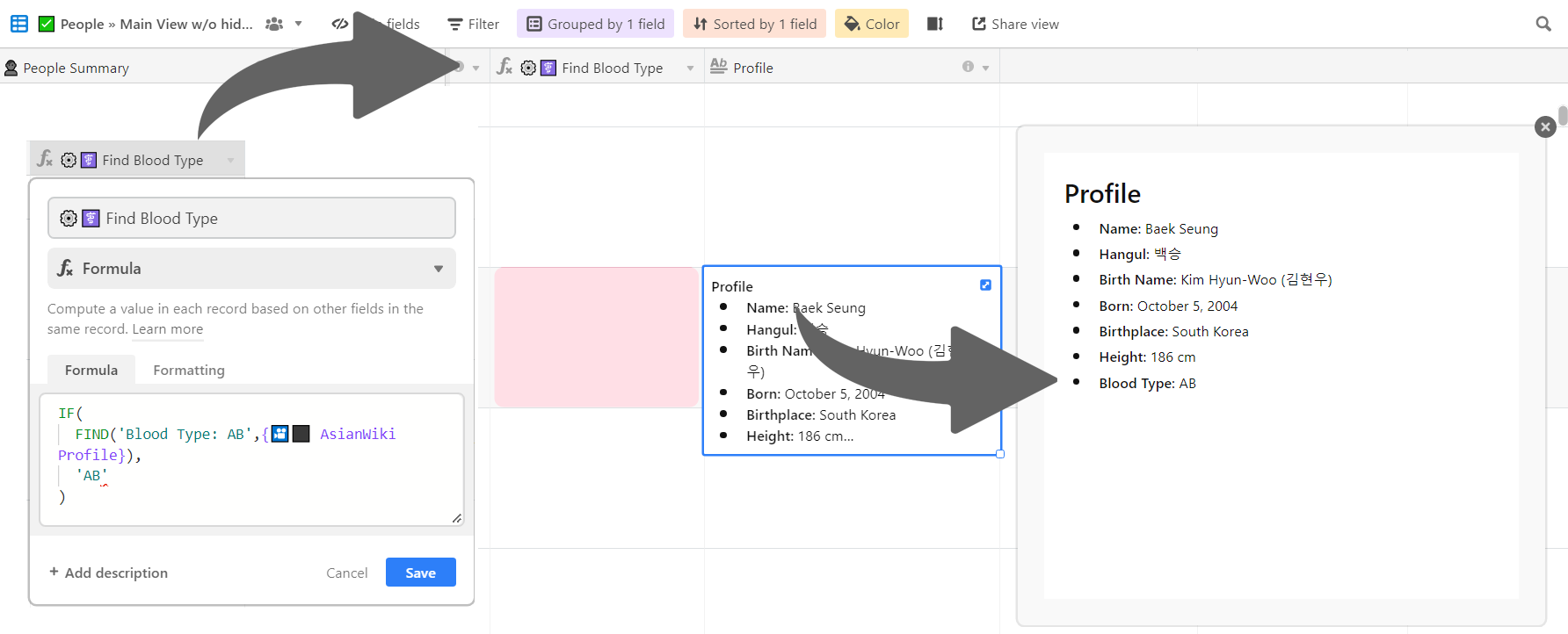

Hmm, check this out
I wasn’t able to add the Korean characters in though. Perhaps those’re what’s causing the FIND() to error out?
And the formula is
  FIND(
    "Blood Type: AB",
    Profile
  "AB"

Hi @Adam_TheTimeSavingCo!
Nope, not the Korean messing it up. I copied your base and added the Korean and it works just fine. But in my base it just doesn’t. If I copy straight from my base to yours, yours doesn’t work for that new record either. There’s something with the markdown going on. A simple find is easy stuff. Not this though.
I created a new formula field to pull in the {Profile} info so I could see the exact markdown, nothing more and it outputs this
"Profile
- Name: Baek Seung
- Hangul: 백승
- Birth Name: Kim Hyun-Woo (김현우)
- Born: October 5, 2004
- Birthplace: South Korea
- Height: 186 cm
- Blood Type: AB
If I simply type what’s on the last line it doesn’t work. I have tried this multiple times before asking here. With and without the -.
If I copy the last line, with the inititial - and paste it in either your or my opening formula it suddenly works. I can’t explain why, but suddenly it works.
I’ll mark your answer as a solution as that is the answer that will help most that check this topic. I guess my base just wants to feel special. :grinning_face_with_big_eyes: Thank you so much for having a look and taking the time.
