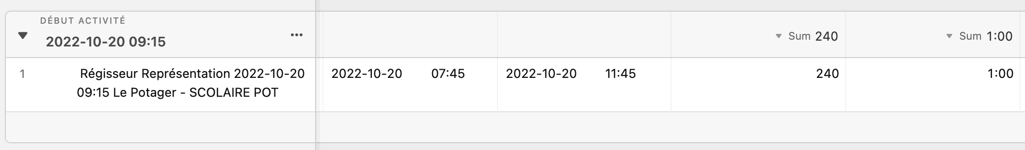

I have a question about a formula field. In one of my bases, I have time sheets with the following fields :
  1. Start (with date) - ‘‘Début affectation’’
  2. End (with date) - ‘‘Fin affectation’’
  3. Lunch break (total time in minutes) - ‘‘Période temps de repas’’
  4. Total time (in minutes) - ‘‘Temps pour feuille’’
The Total time field has the following formula : DATETIME_DIFF({Fin affectation},{Début affectation},‘minute’)
I can’t figure out what to put in the formula to substract the lunch time from the overall hours. Can someone help me? :slightly_smiling_face:
Thank you!

Great!
It is exactly what I was looking for, but I was putting Période temps de repas at the wrong place (before ‘minutes’). So everything is working just fine. Thank you very much!
