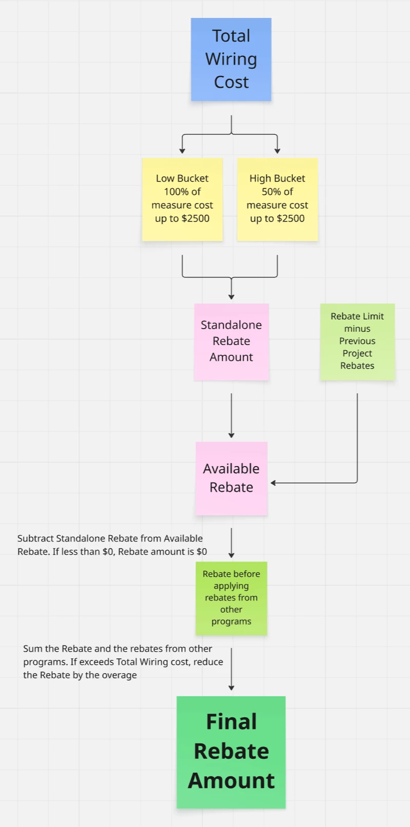

Here’s the latest prompt I tried with the AI, but it could not figure it out.
Create a field that determines what the rebate is for each electrical wiring record. You can use the SOW & Invoices table as well as the Project Addresses table to create fields as needed.
Step 1, determine what the total electrical wiring rebates from previously reserved projects are by summing up Electrical Wiring IRA Rebates for records with the same linked Project Addresses, that have the Selected SOW checked, where the Selected SOW modified date is before the current records date or if no modified date, then ignore this check, that have a status of Approved or Finalizing Rebate Invoice or Completed,  and a Project Status of SOW EA Approved, 3 Day Wait, Installation Approved, Installation Scheduled,  Install in Progress, Change Order, Inspection Needed, Inspection Scheduled, Inspection Rescheduled, Final Document Review, Project Review, State Approval, or Project Complete.
Step 2, determine what the available rebate is by subtracting the amount in the first step from 2500. If this amount is greater than 0, reduce the max rebate of 2500 by this amount. The available rebate should be no less than 0 and no more than 2500
If it helps, here is a workflow of how this should be calculated.

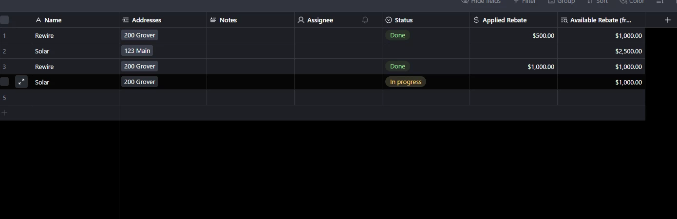

Unless I’m missing something, you should be 99% the way there already.
So you’ve got a functional rollup in your Address table of applied rebates for projects completed related to the address. Now I’d add a simple formula field in the address table with 2500 - {Rollup_FieldName} and format that to currency, so it shows Available Rebate funds. Then in your project field add a lookup field for the formula field you just made. Now you should have a field in your project showing Available Rebate Funds.
I think your circular reference error is that the AI isn't making a differentiation between Available Rebate Funds and Applied Rebate Funds.
