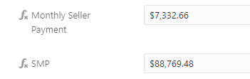

My loan amount was $720K. My interest rate is 4%. My Loan Term is 10 years.
When I used the formula unaltered it returned a value for monthly payment of $88,768.48.
When I adapted it I got a payment value of $7,3332.66 , which is much closer to the PMT formula result in Excel at $7,289.65. Still this $43.01 difference affects another calculation with a much greater discrepancy in comparison.
Below are the results using both formulas. SMP a duplicate field of Monthly Seller Payment.

Here’s why.

Here’s why.
