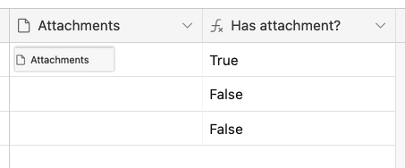

Try just doing "{Ind Doc}" instead?  So you'd end up with:
IF( AND( {Ind Doc}, DATETIME_DIFF( NOW(),{Record Created}, "days" ) >13, DATETIME_DIFF( NOW(),{Record Created}, "days" ) <30), "YES", "NO" )
Here's an example where I just did:
IF( Attachments, "True", "False" )
