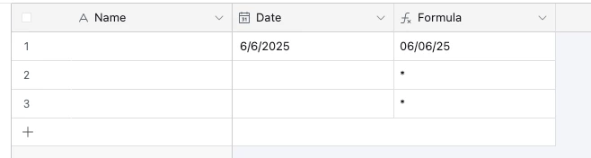

Hey ​@lwetherby,
Agreed: the #ERROR! is not very appealing.
Are you looking to accomplish something like this?
If so, I think you want the following formula:
IF(Date, DATETIME_FORMAT(Date, "MM/DD/YY"), "*")
To explain what the formula does, it first checks if `Date` is empty or not.
If it is NOT empty, then it will format the date with the “MM/DD/YY” specifier (you can learn more about the function here: https://support.airtable.com/docs/supported-format-specifiers-for-datetime-format).
If it IS empty, then it will return the asterisk.
I hope this helps!

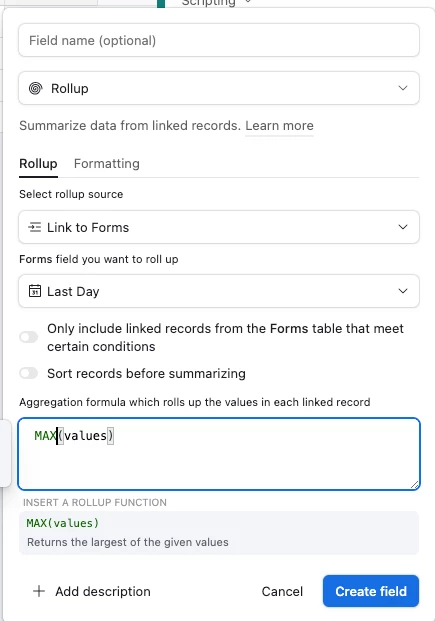

Also, may I ask why you’re using Arrayslice here instead of a Rollup field like this:
You can use the MAX function to get the latest date (if that’s what you’re aiming for)
lwetherby
  • Jun 9, 2025 3:42 PM UTC
That’s great! Using a Rollup with the MAX(values) function fixed my Last Last Day field, so I don’t need my Last Deployment field (which was trying to fix my Last Last Day field).
