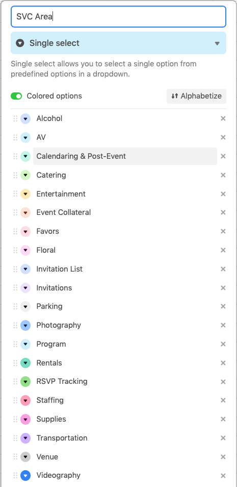

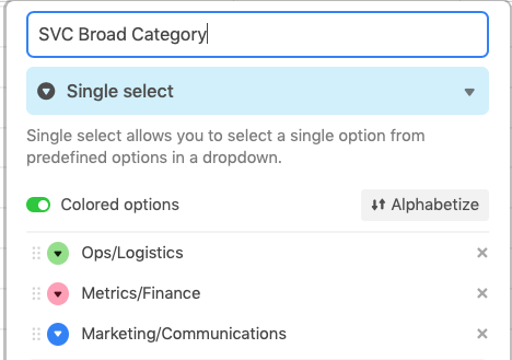

My table has a single select field with 3 options. The field is called SVC Broad Category:
There is another single select field with 20 options called SVC Area:
When we add tasks to the table, we assign them to a SVC Area and to a SVC Broad Category.

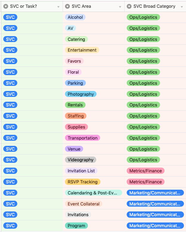

I am hoping for assistance with an IF Statement for SVC Broad Category, so that whatever is selected in SVC Area (e.g. Alcohol) is automatically assigned to the right SVC Broad Category (e.g. Ops/Logistics). The image below shows the Areas and Categories.
