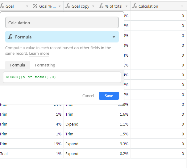

I tried to make another column that just rounded the number so that I could make the formula simpler, and I noticed something weird:
It doesn’t appear to like rounding my numbers :grinning_face_with_sweat:
Oh duh! This is my fault. Wasn’t thinking about the % field, etc. Forget about FLOOR() for now, use…
ROUND({% of total},2)
Just need to remember 1.9% is 0.019. What an idiot I am.
  • September 20, 2021
Oh my gosh, OF COURSE! Thank you so much for seeing that. I would have been staring at the screen for hours more today. I knew I had to be missing something obvious!
