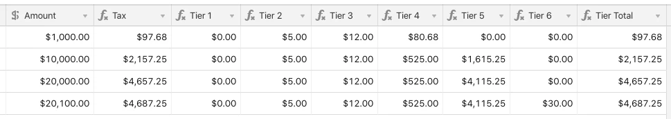

Thanks for the clarification. I haven’t seen that type of calculation before (which isn’t terribly surprising), so your initial description got me thinking in the wrong direction. It took a while to wrap my head around the correct logic, but I got it down to a single formula, using an {Amount} field as the source value:
IF(Amount != BLANK(), (MIN(Amount, 319) * 0) +
(MAX(MIN(419, Amount) - 319, 0) * .05) +
(MAX(MIN(539, Amount) - 419, 0) * .1) +
(MAX(MIN(3539, Amount) - 539, 0) * .175) +
(MAX(MIN(20000, Amount) - 3539, 0) * .25) +
(MAX(MAX(20000, Amount) - 20000, 0) * .3))
While working on that formula, I also found that your most recent example was incorrect. Those amounts only add up to 945. That 17.5% tier amount should have been 461, not 406. It threw me at first because I thought my formula was messing things up, but after double-checking each tier, I found that everything was correct.
To verify, I broke each tier out into its own formula field, ensured that those were calculating correctly, then added those tiers together. In the end, it matches the single formula version.
The {Tax} field in this screenshot is the single formula version, while {Tier Total} is the sum of the individual tier fields.
  • September 23, 2020
Thanks again Justin!! It works perfectly well.
