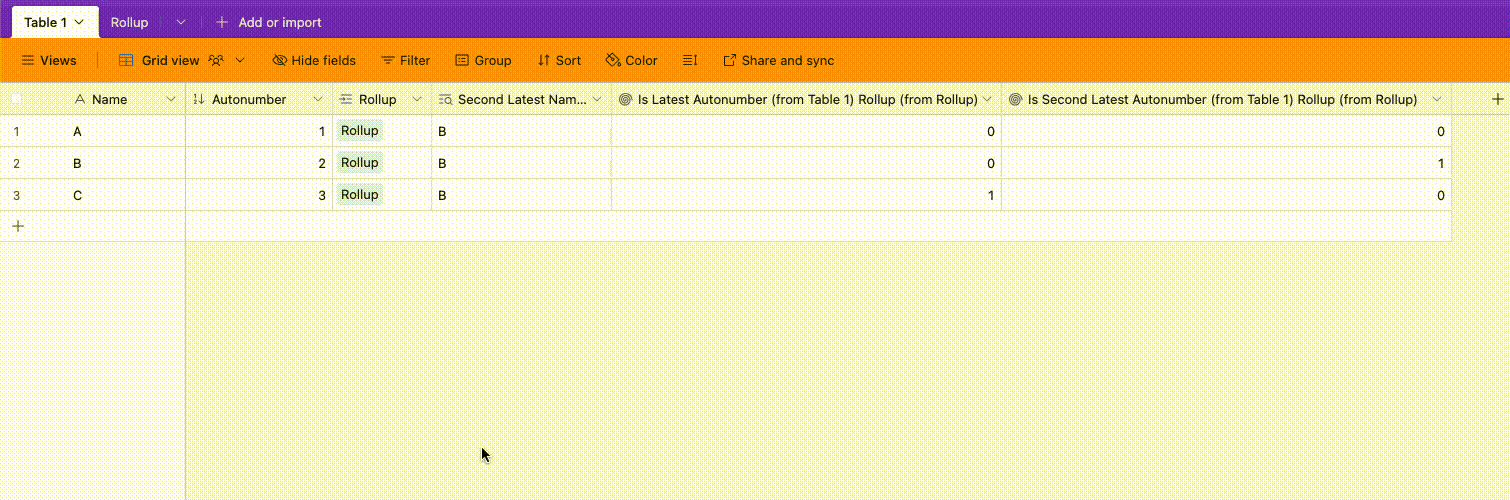

If so, I’ve set it up here for you to check out!
Set up might get confusing, so I suggest duplicating the base into your own workspace and poking at it heh
  1. Create a new table where you’ll create a single record to link all your existing records to.  I called mine ‘Rollup’
  2. In ‘Rollup’, create a rollup field on the ‘Autonumber’ field with the formula ‘MAX(values)’ to display the latest Autonumber value from Table 1
  3. In ‘Table 1’, create a rollup field on the field from step 2, with the formula ‘SUM(values) = Autonumber’ that’ll help you identify the latest record

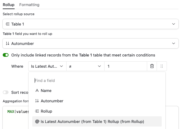

  4. In ‘Rollup’, repeat step 2, but this time use a conditional filter to only display the Autonumber where the field from step 3 is not equals to 1
  5. In ‘Table 1’, create a rollup field on the field from step 4, with the formula ‘SUM(values) = Autonumber’ that’ll help you identify the latest record

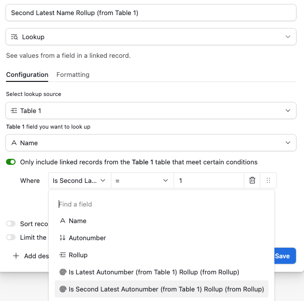

  6. In ‘Rollup’, create a lookup field to display the value you want by using a conditional:
    1.
  7. In ‘Table 1’, create a lookup field to display the field we created in step 6
