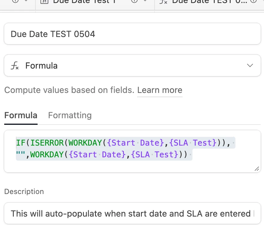

Thank you. How do I add the original formula and one of the formulas you provided? Can I have two formulas together? If so, how does it look?
  • May 3, 2023
Hi @JaclynB, both of the formulas in my initial response include your original formula. The two formulas I offered are two ways of doing the same thing. You can use the one you prefer.

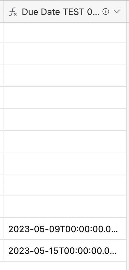

Thank you for your help. The errors are gone however the formatting is not correct. Can you help me so it shows as a (work) day?
Background:
When start date and SLA number are entered the due date automatically updates using a work day formula.
