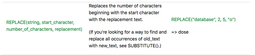

REPLACE needs 4 parameters:
The 4 parameters was the bit I was missing.
Ended up with:
SUBSTITUTE(REPLACE(ARRAYJOIN({Roll up warning}),1,1,’’),’,’,’\n’)
