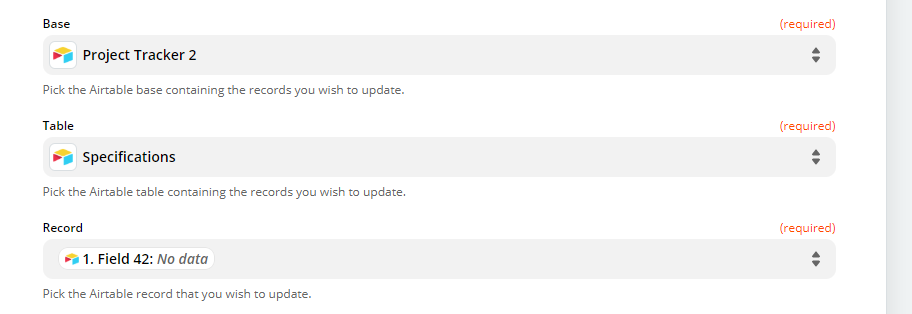

I tried that and I got it working for 1 record but first in Zapier, I had to specifically choose that record to update it. New records added to the table do not update. So I tried something else but it doesn’t work:
When setting up the Zap, in step 2, there are 3 required fields, Choose the base, Choose the Table and then Choose the record you wish to update. In this 3rd required field, I guess that I want to update the field which I want to copy the data to? At the moment of setting up the Zap, this field contains no data. This Zap should copy data from Postcode Area to Field 42.

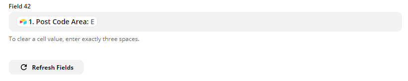

Then as you mentioned, further down the page, I find the Field 42 field and select 1. Postcode Area to be inserted.
When I run this test, I get the error that “Required field “Record” (rowId) is missing.”
Am I missing something?
In the Record field in Zapier, you want to select the Record ID from the first step so that it knows it will update this specific record. When a new record is added to Airtable, Zapier will change this value to the new record id.
Check it and let me know :slightly_smiling_face:

Hi @Mohamed_Swellam
Thanks for helping :slightly_smiling_face:

Hi @Mohamed_Swellam
@Mohamed_Swellam Super! that works perfectly, thanks so much for your help :v:
