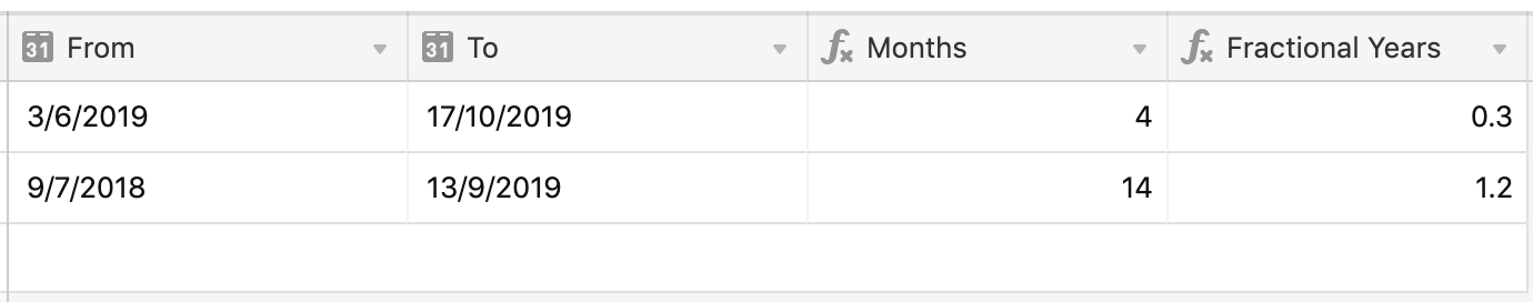

Hi @Dennis_Stevens - use ‘months’ in your date diff formula, then divide the result by 12:
(DATETIME_DIFF(To, From, 'months'))/12
JB

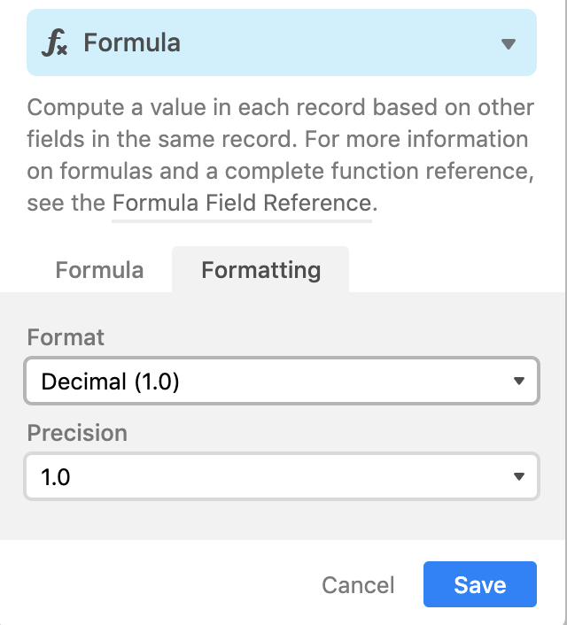

Ah, OK, you need to look at the formatting option on the formula field - change this from integer to decimal:
JB

That’s it! Perfect; thank you very much. I’m new to Airtable and had a project ready to go so I’m heading out without much experience with it yet. So far, I love.
Thanks again.
