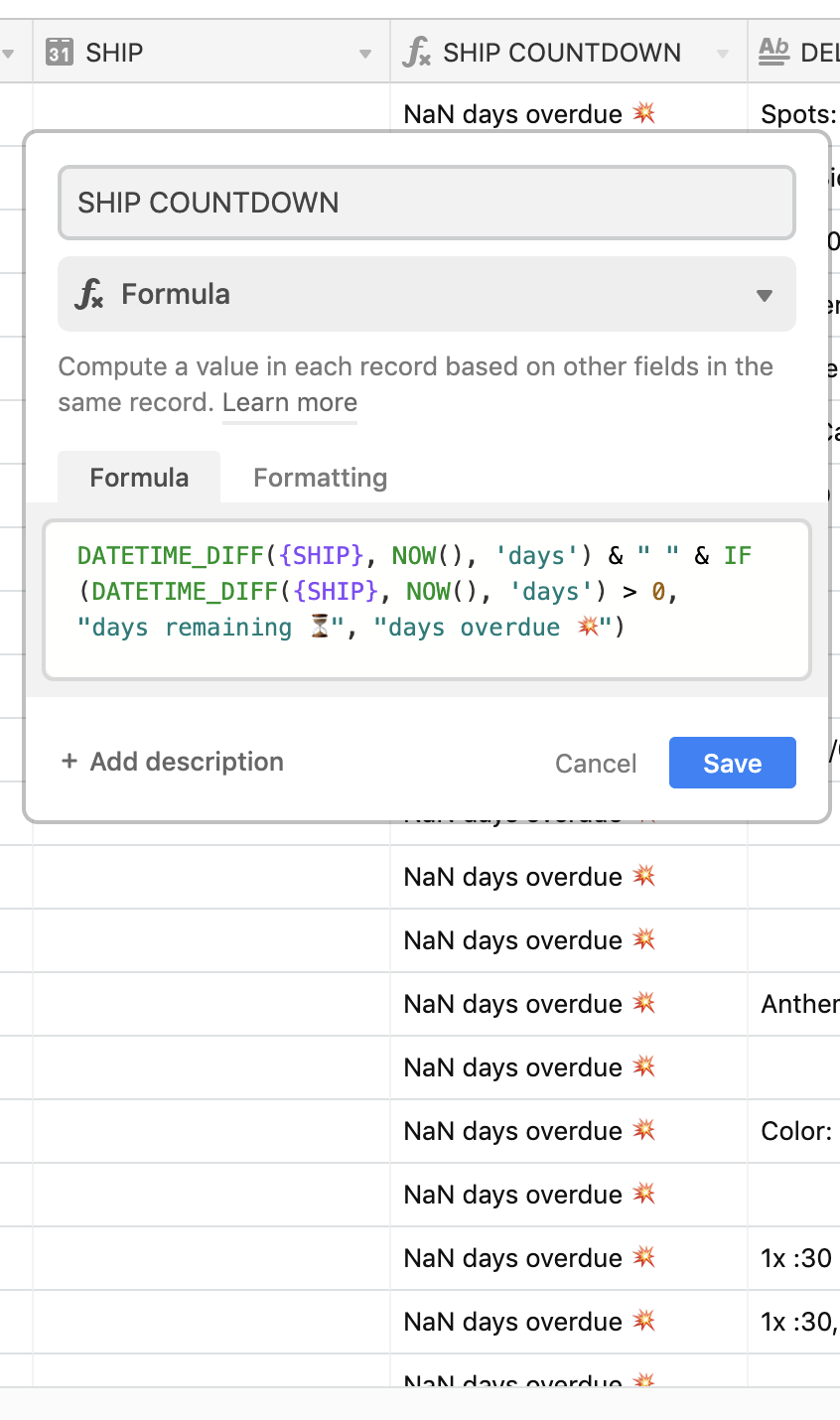

Need help correcting the NaN from my formula
  • Nov 9, 2022 8:13 PM UTC
  • 7 replies
  • 140 views
Hi there! I am looking to add to my formula (below and attached) that when the date is blank or 0 for the field to say “due today”
CURRENT FORMULA
DATETIME_DIFF({SHIP}, NOW(), ‘days’) & " " & IF(DATETIME_DIFF({SHIP}, NOW(), ‘days’) > 0, “days remaining :hourglass_flowing_sand: ”, “days overdue :boom: ”)
Best answer by Jeremy_Oglesby

Hi @Nicole_Abascal
You can wrap the whole thing in another conditional like this:
  OR(
    DATETIME_DIFF({SHIP}, NOW(), ‘days’) = BLANK(),
    DATETIME_DIFF({SHIP}, NOW(), ‘days’) = 0
  "due today",
    “days remaining :hourglass_flowing_sand:”,
    “days overdue :boom:”

Thank you so much for your help, Jeremy! I didn’t think anyone would respond.
Unfortunately formula did not work and I did not ask my question properly (apologies).
When the SHIP date is empty, I would like the SHIP COUNTDOWN to also be empty. When the SHIP date is the actual day (0 days), I would like the SHIP COUNTDOWN to read “due today.”
Aaahhh, gotcha, ok… let’s try this then:
  {SHIP},
    DATETIME_DIFF({SHIP}, NOW(), 'days') = 0,
    "due today",
    DATETIME_DIFF({SHIP}, NOW(), 'days') & " " &
      DATETIME_DIFF({SHIP}, NOW(), 'days') > 0,
      "days remaining ⏳",
      "days overdue 💥"
And I just realized that the reason the first formula didn’t work is because I forgot to fix the quotation marks in it to make them all ‘straight’ quotation marks instead of ‘curly’ ones… Airtable’s formula editor is really picky about that.
  • Nov 9, 2022 11:43 PM UTC
Thank you so much, Jeremy! It worked and appreciate your help/patience!!
  {SHIP},
    "due today",
      "days remaining ⏳",
      "days overdue 💥"
Hey Jeremy, Could I have your wisdom on another component of the formula?
If the OVERALL STATUS has the status SHIPPED or PARTIALLY SHIPPED, I would like the formula to say “shipped”.
@Nicole_Abascal, try this:
  FIND("Shipped", {OVERALL STATUS}),

  • Nov 10, 2022 9:22 PM UTC
  "shipped",
    {SHIP},
      "due today",
        "days remaining ⏳",
        "days overdue 💥"
Brilliant!! That did the trick and it looks incredible. Thank you so so much!
