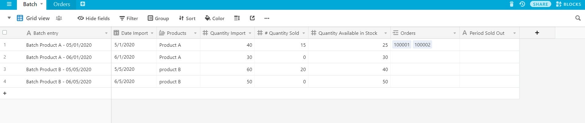

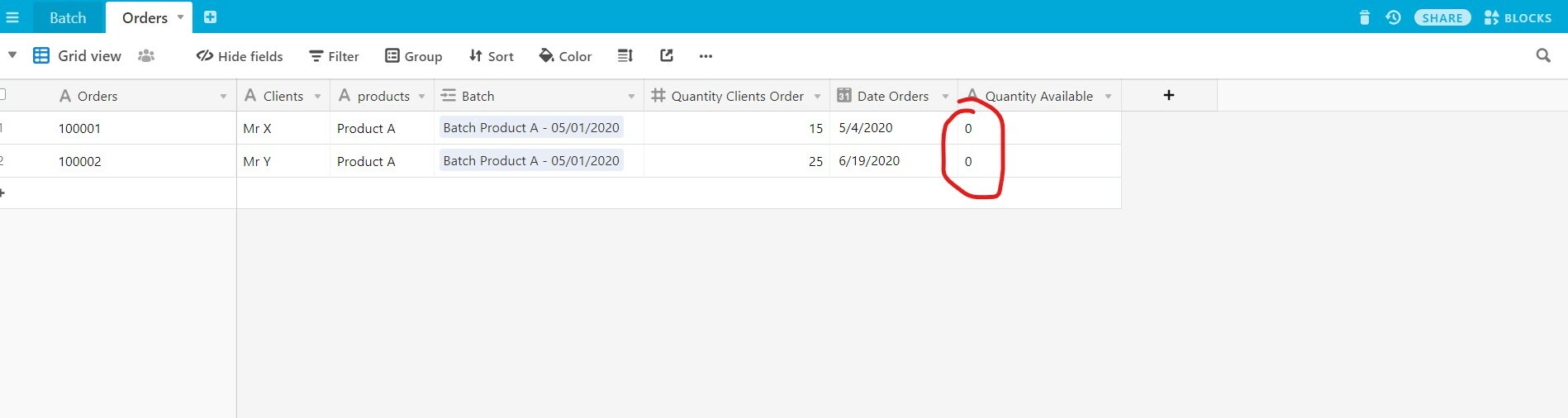

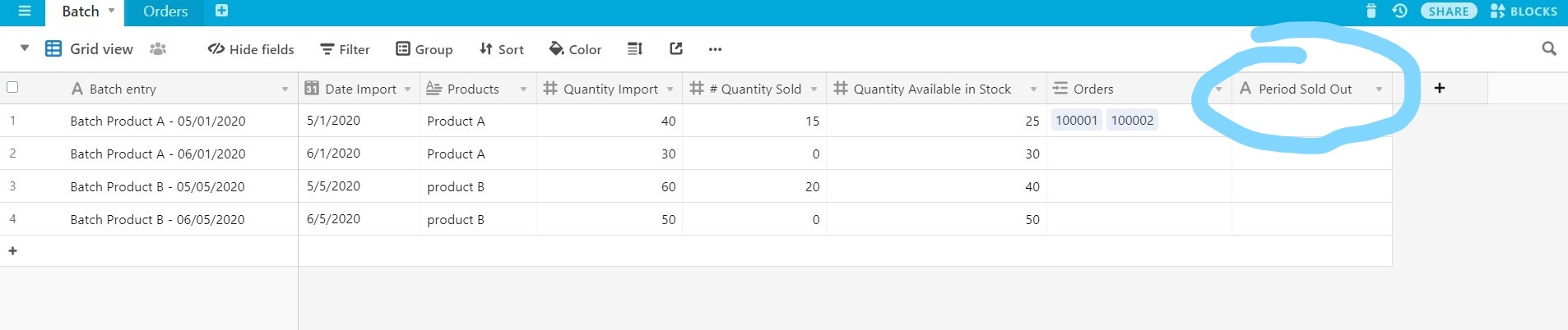

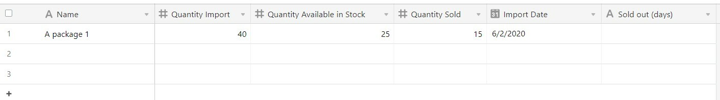

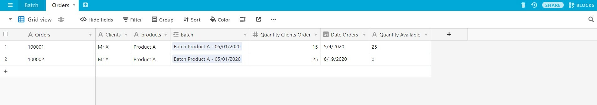

I 'm trying to create a quick base with 2 table without modify any fields in here that you can imaging:
Table 1- Batch:
Table 2- Orders:
You can see Orders tables, when {Quantity available} = 0 for Batch 1 of product A , I wanna to get that Date Orders Values
So now in Batch Tables, i wanna to calculate period out stock of each batch by {Using Final Date Orders above } - {Import Date of that batch}

That makes it much clearer :slightly_smiling_face:

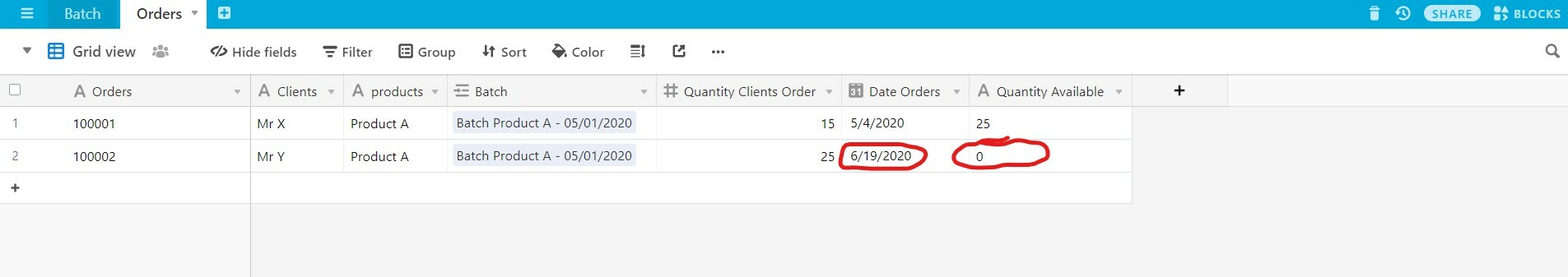

Well, you can make something else, make a field in Orders and call it Date Sold Out On. It should be a Formula field with the formula being
IF(Arrayjoin({Quantity Availability})=0, {Date Orders}, Blank())
This will bring the date when the item is sold out. Then, you can use this in a Lookup Field in the Batch table.
Does that solve your problem?

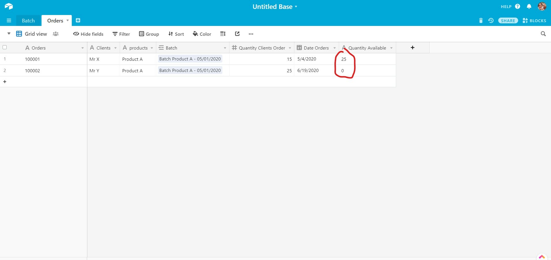

Now another issues, This’s when i mannually type the quantity available
But when i come to formula table, the values 25 didn’t lock, it link and change to 0
So when i create insert a new field like your advice, it feels not right. How can i lock the values at that time ?

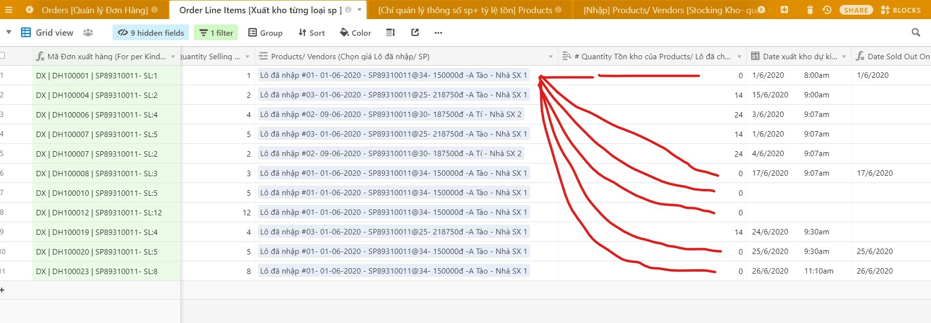

Here’s the real one.
Table Batch: with product: SP89310011 - Quantity import: 34 products on 01/06/2020
And here’s Order table:
As you see, the first clients only buy 1 products, so quantity in stock must be 33 (but you see 0), the 6th clients buy 3 products, so it should be display = 30 (The lock values i means 's here, just display the current values not subtract all like this) instead of 0 as you see . In Quantity available field, it linked and final quantity avaible changed. So i got 4 values from {Date Sold out} when i use your formula

Ah ok, I thought you are entering the numbers manually for some reason, I didnt know you are doing rollups and looks ups for the quantity.
You can do what you want in other ways.
  1. You can use zapier to update the current qty (would be a bit complicated to explain in details here but it can be done)
  2. You can use the Script Block as shown in this post
  • June 25, 2020
