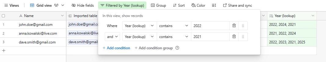

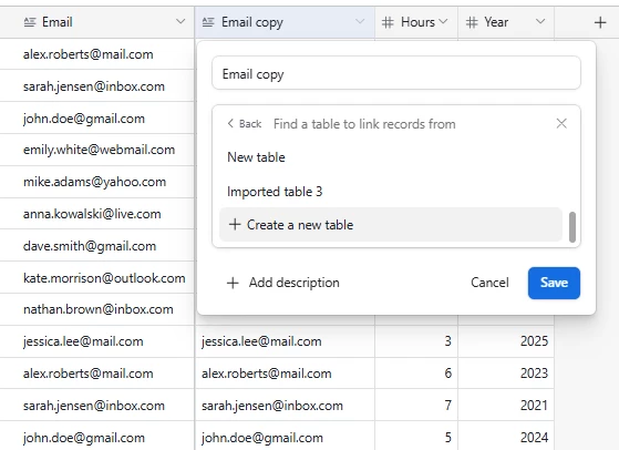

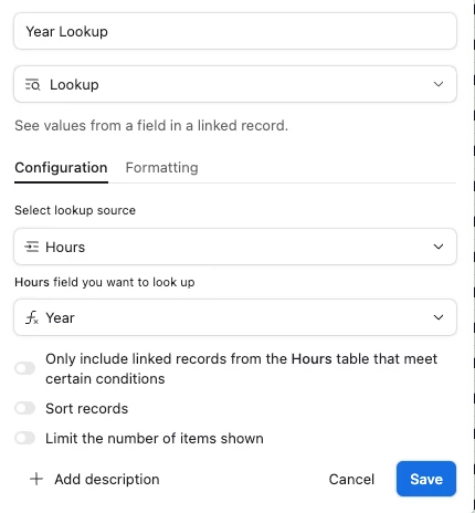

The formula not working because in a single table, records 'doesn't know' about each other. The common approach to all kind of 'vertical' totals, grouping, creating pivot table is - to create other linked table. There can be a lot of such tables including temporary..
You need to ungroup you table, then just duplicate email field and make it linked
In a new table, you can add Year as lookup and filter as you need

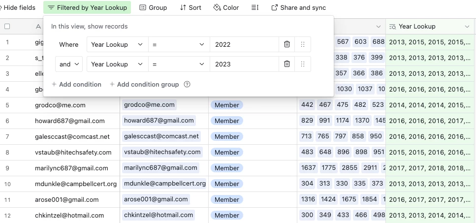

Thank you Alexey - I was able to follow your explanation and the solution worked.  The only peculiarity was that your where clause used the "contains" operator, but I was not given that option.  When I added filters for "year lookup", my only options were logical operators such as ==,>,<, empty, etc.  I thought perhaps this is due to something be a number versus text but was not sure?  I attached a screenshot of the filter drop down and the year lookup field
Yes, you are right. Lookup is computed field and it depends on format in source table. I intentionally made the Year field in text format, because I wasn't sure how to filter 2 different years with "=". But as we can see, in Lookup, '=' works in the same way as 'contains'.

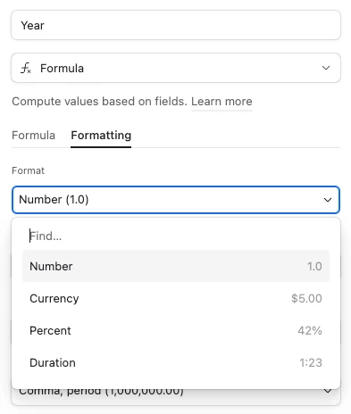

Thanks for confirming; helps me to improve my airtable proficiency.  It is curious to me that "is" or "=" works since the lookup is a kind of list or array of values and those operators would suggest an exact match to the entire list rather than "contains".  Anyway, I tried to duplicate what you did, but when I try to change the format of the "year" field it does not provide "text" as an option.  The Year field in the original table was actually a formula that extracts year from a date (see screenshot attached) and I could not find a way to make either that field or the field in the copied table a text field
Well, I just asked LLM to create a small table with email, hours and year.
I think you don't need to change anything.
But in cases like this you can't choose text format because data type and format are different things.
You need to explicitly convert numeric data into text or vise versa.
To get text data you can add another field with CONCATENATE({Lookup field}) - it will convert array to a text string. Or, in source table you can change formula. YEAR(DATE)  is number , but YEAR(Date) & ``  is text, just add empty string or wrap it into CONCATENATE()
