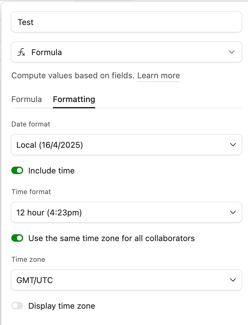

That did it, thank you!!! One last question. My other 2 date fields use Pacific/Los Angeles time zone, but the formula field is using GMT. Would I use the DATETIME_PARSE function? And how would I add that to the above formula? Thanks!
mtrebinonixon
You can format this new formula field just as you did with the other 2 date fields. It detects that the output of the formula is a Date, so when you open the formula field’s configuration you’ll be able to set the time zone in the “formatting” section.
  • April 16, 2025
AH! I totally overlooked the FORMATTING tab. Thank you again! Really appreciate the help.
