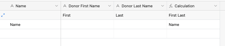

Hey Airtable community,
Been hitting my head against the wall for the last hour with this. I'm trying to write a formula for:
If {Donor First Name} is not empty, then the field would read: {Donor First Name}&" "&{Donor Last Name}
And if {Donor First Name} is empty, then the field would read: {Name}
And if {Name} is empty, then the field would just remain blank.
Here is my stab at the formula, which I am getting an error message for:
Any ideas how to make it work?
Best answer by Mike_AutomaticN
Hey! Do you mean Name, or People (as shown in formula?). In any case, try this formula:
{Donor First Name},
{Donor First Name} & " " & {Donor Last Name},
{Name},
{Name},
BLANK()
{Donor First Name},
{Name},
{Name},
BLANK()
Your formula works fine, you've just got some issues with the parentheses.  Try this:
IF( NOT({Donor First Name} = ""), {Donor First Name} & " " & {Donor Last Name}, IF( {Donor First Name} = "", Name, "" ) )
Link to base
Check out Mike's answer to see how your formula can be simplified though!
Thank you, I got it working!! 😃
