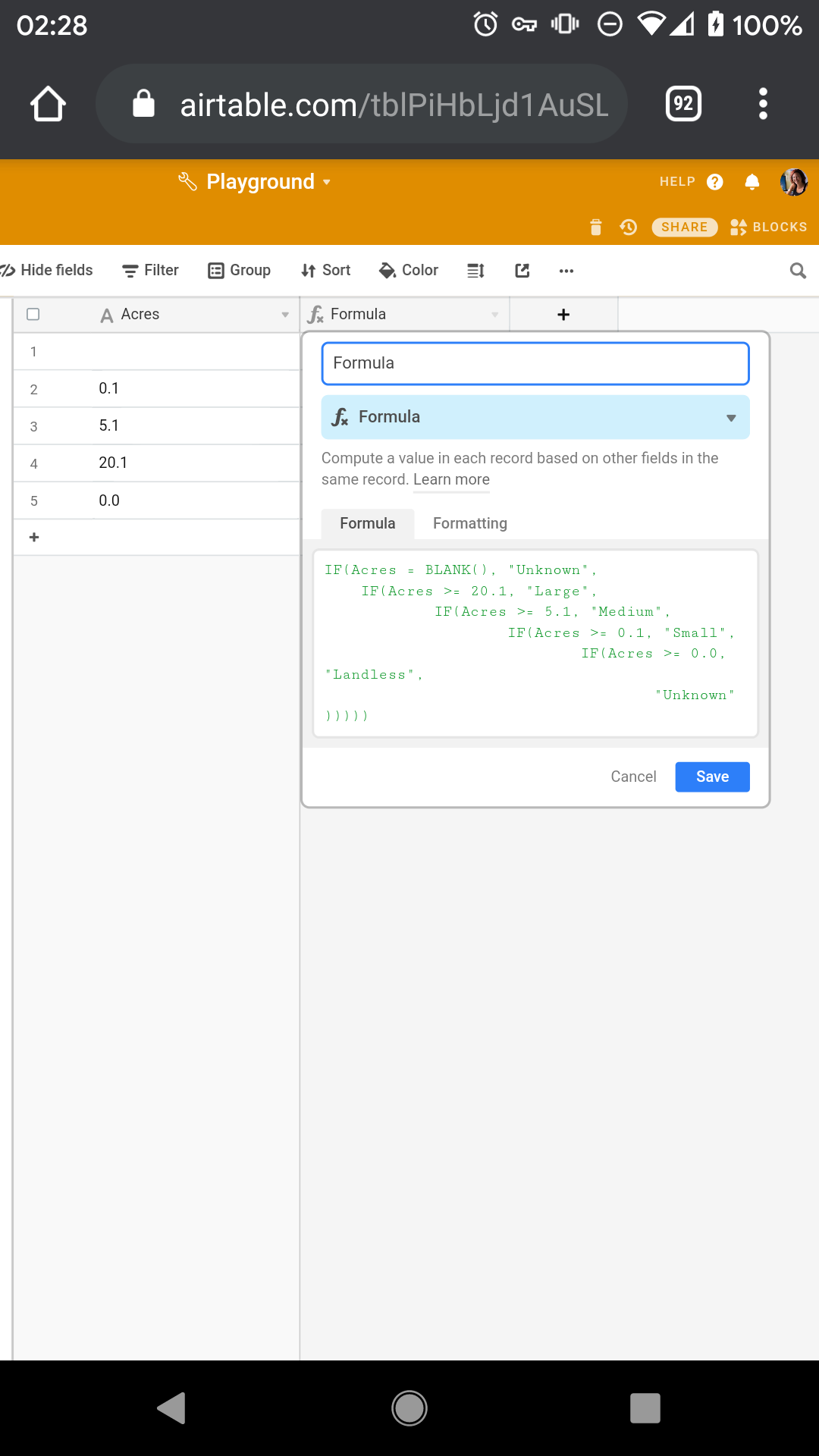

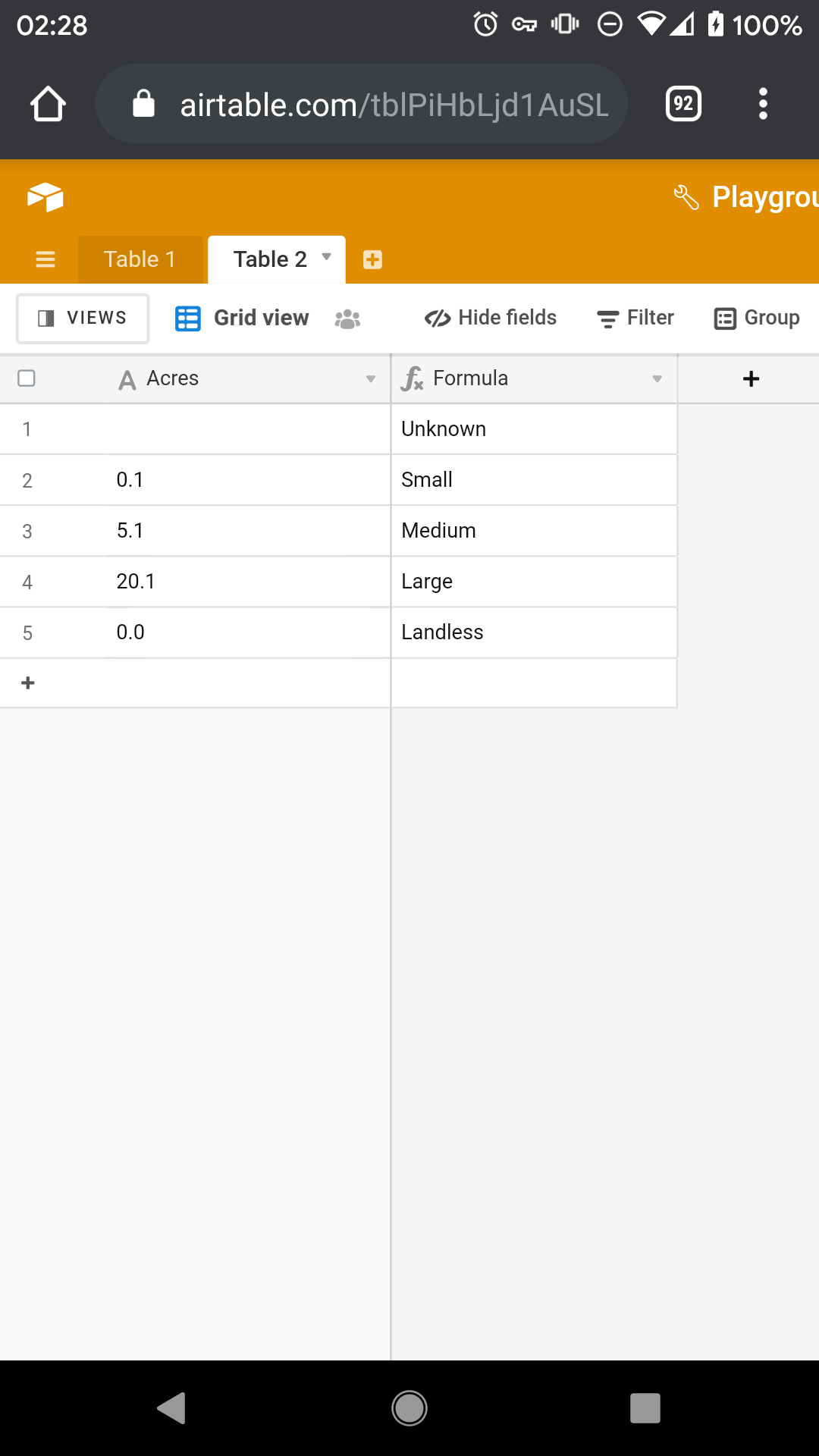

Hello!
Give this a shot. I swapped the “” for BLANK() and my quick test seems to be producing your desired results!
IF(Acres = BLANK(), "Unknown",
IF(Acres >= 20.1, "Large",
    IF(Acres >= 5.1, "Medium",
	    IF(Acres >= 0.1, "Small",
		    IF(Acres >= 0.0, "Landless",
			    "Unknown"

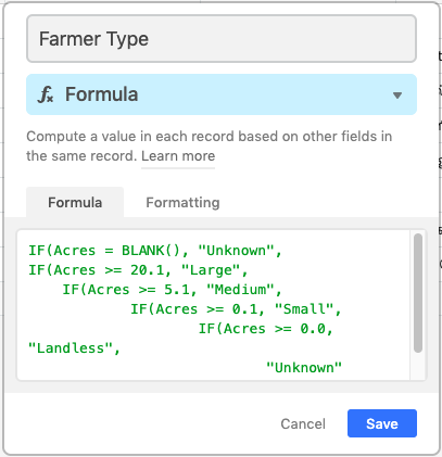

Thanks @ScottWorld
Sorry, my bad. I pasted the wrong/old snippet earlier. I do have Blank() in the code. Please see screenshot attached. Still 0.0 is resolving to ‘Unknown’
Current Code:

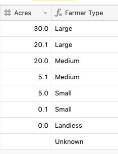

If you don’t have to worry about negative numbers, try this formula.
      IF(Acres >= 0.1, "Small", "Landless"

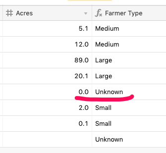

This one still has problems between landless and unknown. Both those are resolving to unknown.
