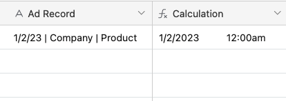

Hello! I'm sure there is a very easy solution for this but I am having trouble figuring it out!
I have an "Ad Record" field that may or may not have a date at the start (ex. "1/2/23 | Company | Product"). This formula parses out the date for me easily enough:
DATETIME_PARSE({Ad Record},'MM/DD/YYYY')
However, sometimes there may not be a date (ex. "Company+") so the above formula parses an ERROR. What sort of IF statement would work here to instead leave the field empty?
This didn't work for me:
IF({Ad Record}, DATETIME_PARSE({Ad Record},'MM/DD/YYYY'), "")
Thank you!
Could you try the following?
IF( ISERROR(DATETIME_PARSE({Ad Record},'MM/DD/YYYY')) != 1, DATETIME_PARSE({Ad Record},'MM/DD/YYYY') )

That worked! I knew it would be something simple.
Thank you so much!
