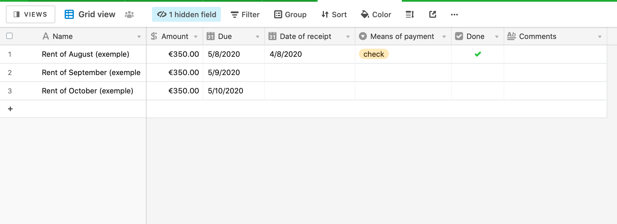

I created a payment tracker, which allow me to track every rent from tenants. You can find the sheet here (translate in English). Usually, rents are grouped by tenants, but for the translation I do not have copy them.
When I receive a payment, I write on the record the date of receipt, the means of payment and I check the “Done” field.
To quickly see what rent I need to claim for the month, I am looking for a formula that shows “LATE PAYMENT” in red for every rent that I do not receive when the “Due” date is over.
Exemple : Every rent for September must be paid at least on 5th September. If a tenant do not paid the rent on 6th September, the formula field in “Rent of September” will be shows “LATE PAYMENT” in red.
Can you please tell me what formula I need to write to make this happen ?

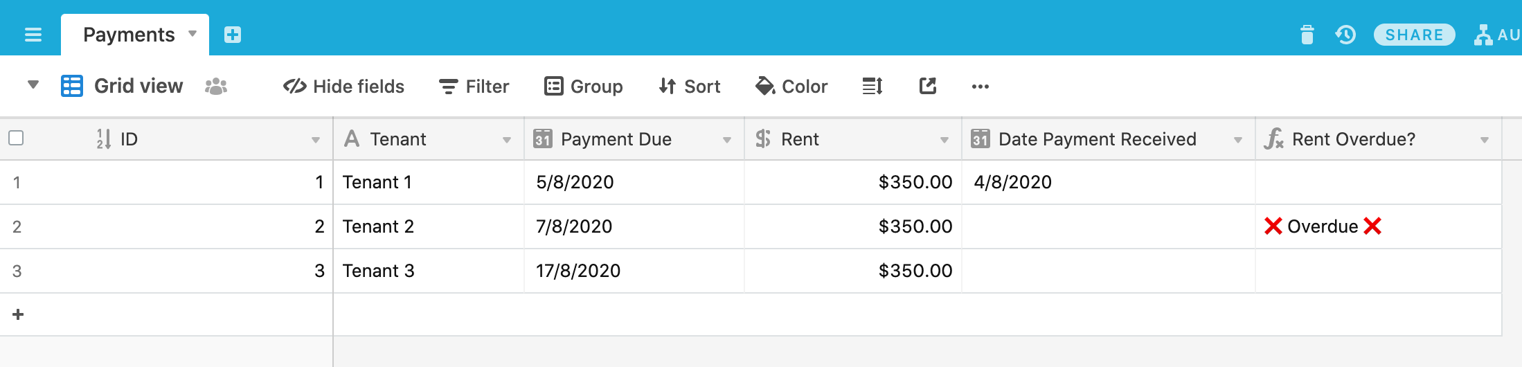

Hi @Papillonhostel - you can do something like this:
The “Rent Overdue?” field is a formula:
IF(AND({Payment Due} < TODAY(), NOT({Date Payment Received})), '❌ Overdue ❌')
This is saying:
If payment due date is before today AND there’s no payment received, then show as overdue

It is very similar. If you had a checkbox for “Housing Assistance Received” then you could have another formula field:
IF(AND({Payment Due} < TODAY(), NOT({Housing Assistance Received})), '❌ HA Overdue ❌')
