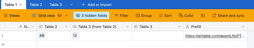

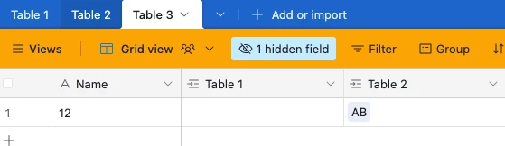

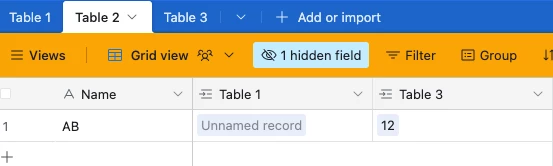

Hmm, so the third table is linked to the primary table, and you want to prefill it with the secondary table record’s link to the third table?  Assuming my understanding’s right, I did that by creating a lookup to display Table 2’s linked field to Table 3, and then used the following formula:
CONCATENATE(
"https://airtable.com/appmLNzPTq6TdFL1Y/shrwFK3qWmTMfEypd",
"?prefill_" & ENCODE_URL_COMPONENT("Table 2"),
"=" & ENCODE_URL_COMPONENT({Table 2} & ""),
"&prefill_" & ENCODE_URL_COMPONENT("Table 3"),
"=" & ENCODE_URL_COMPONENT({Table 3 (from Table 2)} & "")
Sorry, I don’t think I really understand what you’re trying to do.  If you could provide screenshots that’d be helpful!
