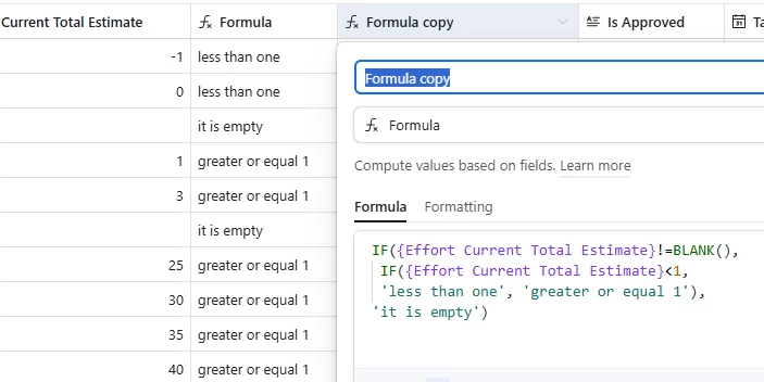

You can set any order and type of IF checks. You can mix blank, GEO 1 and  LT 1
Actually it doesn’t need nothing special, just write them in exactly the same order as your conditions in text.
Now, y​​​​our conditions are wrong. (And formula doesn’t follow, even if they were correct, because you inverted the order)
3 and 4 will never be checked, because according to (2),
If Approved and Effort greater than or equal to 1 = Dev Pending
Another example
“ use the substate switch then the state switch”
means “Check {Substate}, and if “Fix”, type “Dev,  if “Review”, type "Feature Complete"..etc
                      that also means  “if I found match, then it doesn’t matter what’s in “State””
only if SWITCH({Substate} finds nothing from list above, it will check for {State}
