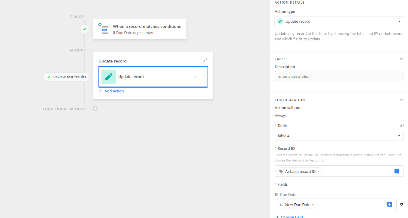

You could then add an automation that has a condition of the original due date being ‘yesterday’
  • Then update record with the new due date.

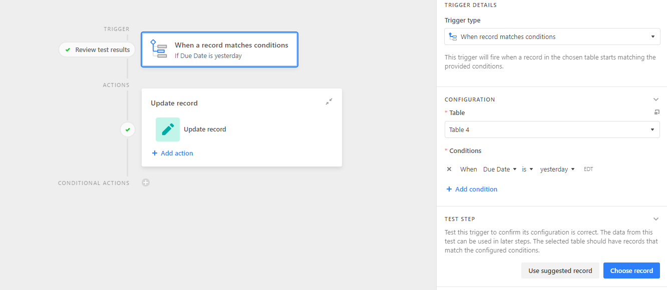

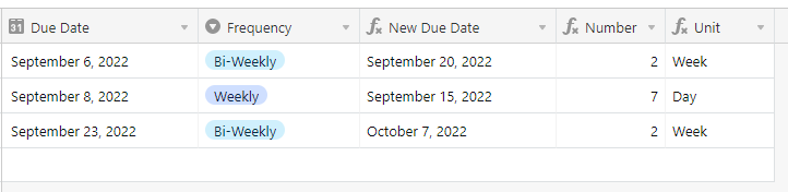

Base Setup:
Automation Setup:
Base Setup:
Automation Setup:
