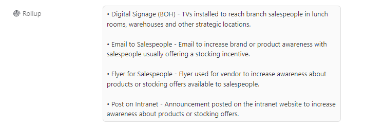

Hey @LeighAnnMoltz!
Based on the information you provided, I put together the following example:
To do this, I implemented a rollup field with the following formula:
IF( values, IF( COUNTALL(values) = 1, "• " & TRIM("" & values), IF( COUNTALL(values) > 1, "• " & TRIM( ARRAYJOIN( values, "\n• " ) ) ) ) )
You can define a custom separator by replacing the dot symbols in the formula. If you want a hard break between each item, then you can insert an additional new line operator like this:
IF( values, IF( COUNTALL(values) = 1, "• " & TRIM("" & values), IF( COUNTALL(values) > 1, "• " & TRIM( ARRAYJOIN( values, "\n\n• " ) ) ) ) )

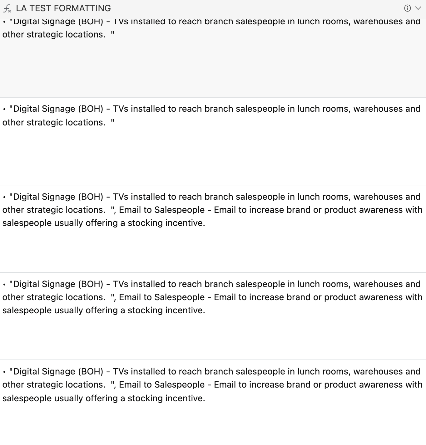

My implementation is incorrect. This is what it looks like:
 This is how I plugged in your formula:
{Marketing Tactic - Detail},
COUNTALL({Marketing Tactic - Detail}) = 1,
"• " & TRIM("" & {Marketing Tactic - Detail}),
COUNTALL({Marketing Tactic - Detail}) > 1,
TRIM(
ARRAYJOIN(
{Marketing Tactic - Detail}, "\n• "
What did I mess up?

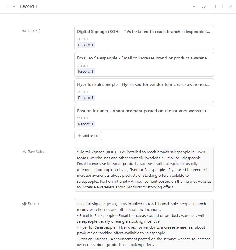

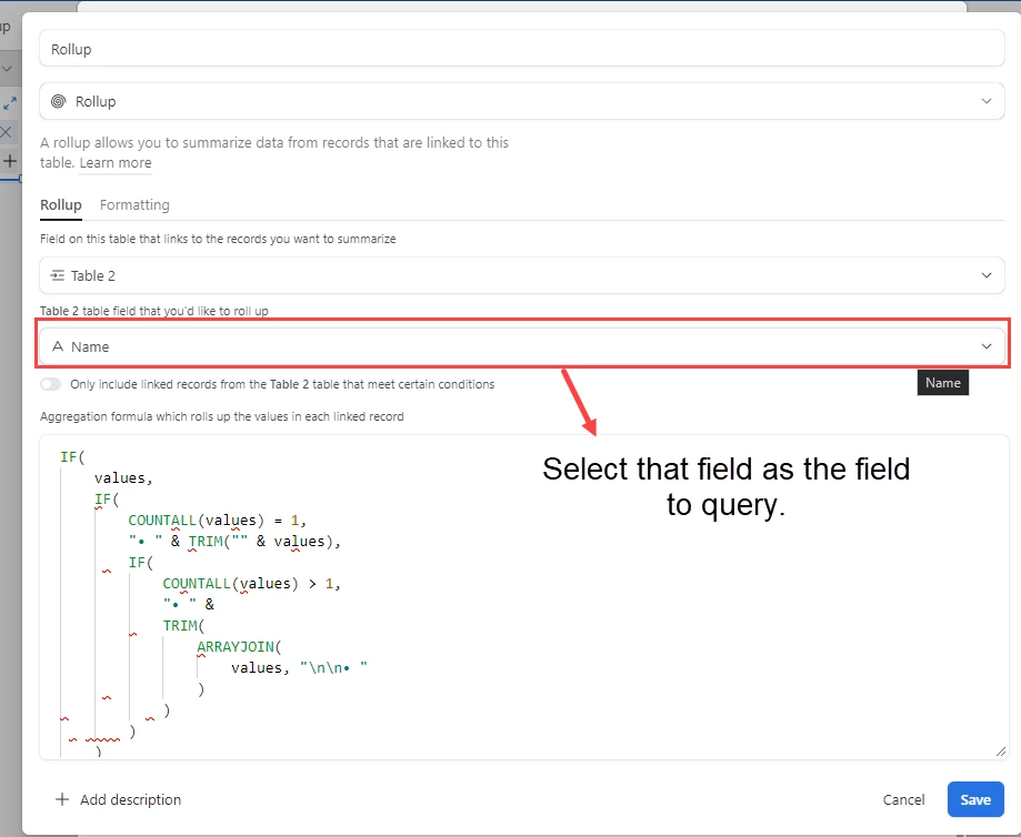

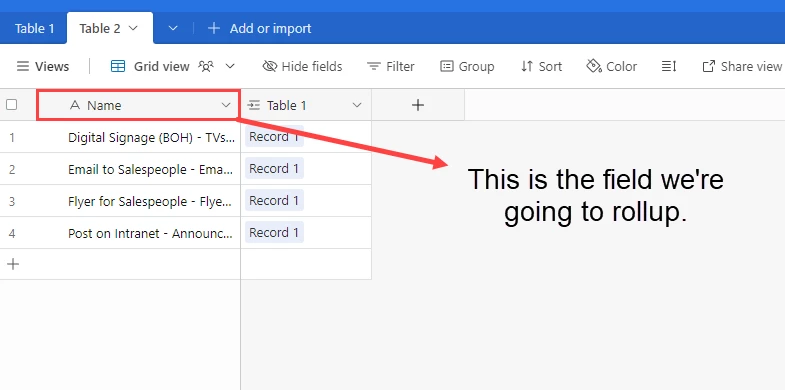

Instead of a formula field, you need to create a rollup field.
If you use the rollup field, you can just copy and paste the exact formula I posted; you won't have to change it at all.
Here are some screenshots for additional context:
After saving the field, we get:
I think I understand. You're able to use "rollup" because those multi-selects are records in another table that you're linking. Thus, rollup.

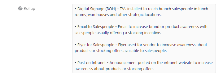

I decided to bite the bullet and switch it over while I was waiting lol only took a few minutes, I just didn't want another sheet in the base. It's for the best! Thank you for your help. This is exactly, exactly, exactly what I needed. I wouldn't have figured that formula out!
