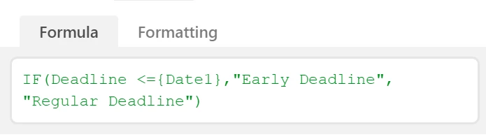

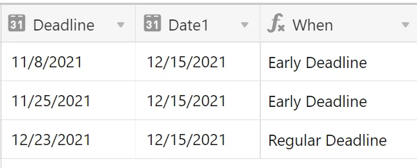

Hannah_Wiginton
Hey Heidi!
You can create another date field and enter the 12/15/21 date in all rows. You can then hide that field. Then, the formula will work. :grinning_face_with_big_eyes:
Here’s the formula:

  • November 16, 2021
Thanks to both of you! Both solutions worked.
Heidi
