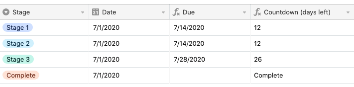

SWITCH(
   {Stage},
      "Stage 1",
         DATETIME_DIFF(DATEADD({Date},14,'days'),NOW(),'days'),
      "Stage 2",
      "Stage 3",
         DATETIME_DIFF(DATEADD({Date},28,'days'),NOW(),'days'),
      "Complete", "Complete"
This uses the SWITCH() function rather than IF statements for a slightly more straightforward approach. You’ll see in the GIF below how the countdown adjusts based on the entered date and the current time (the NOW() function in the formula).
Let me know if that helps!

SWITCH(
   {Stage},
      "Stage 1",
      "Stage 2",
      "Stage 3",
  • July 2, 2020
Well that definitely worked. Thanks a ton!!
