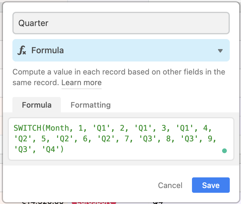

Is there any way to shorten this formula?

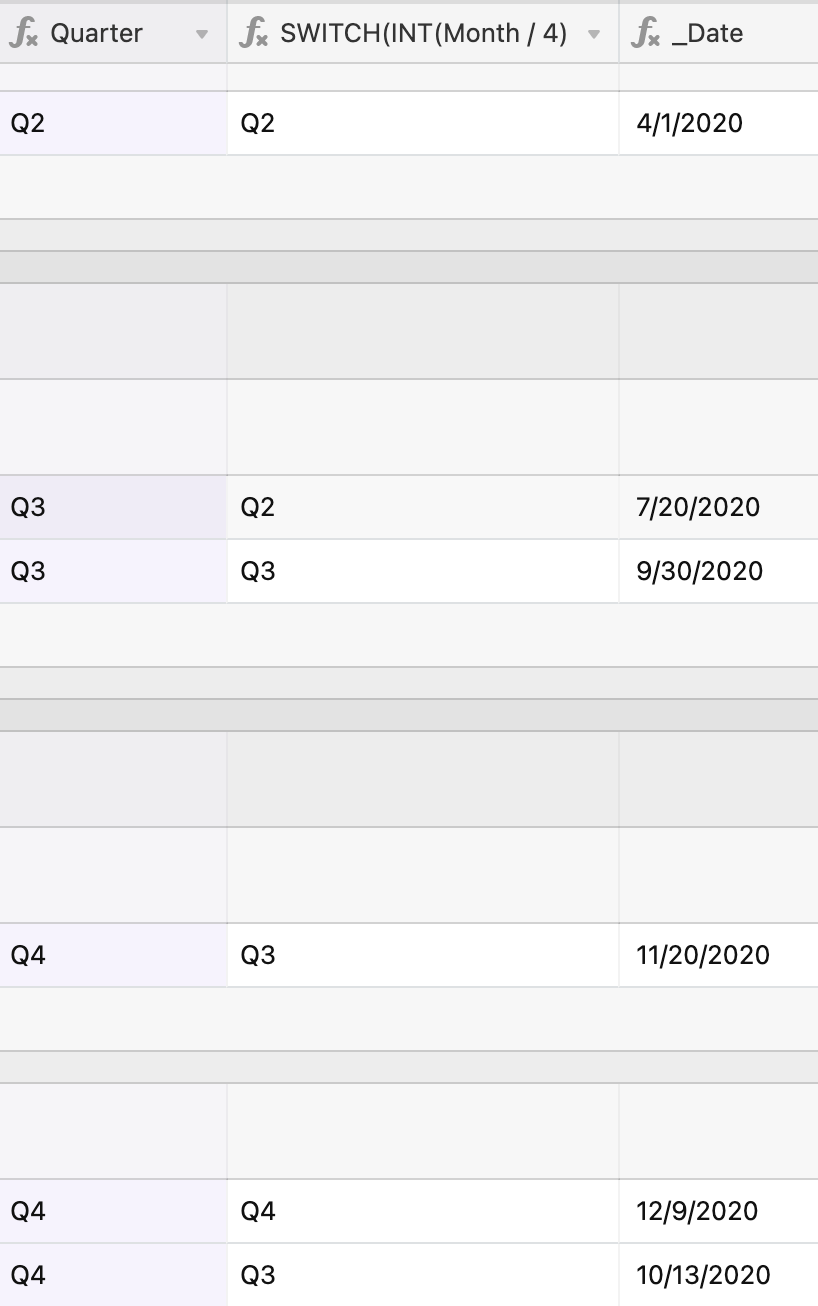

There some issues with the INT methods due to β€œroundness”…
But I found happiness with
CONCATENATE(β€˜Q’, DATETIME_FORMAT(Date, β€˜Q’))
