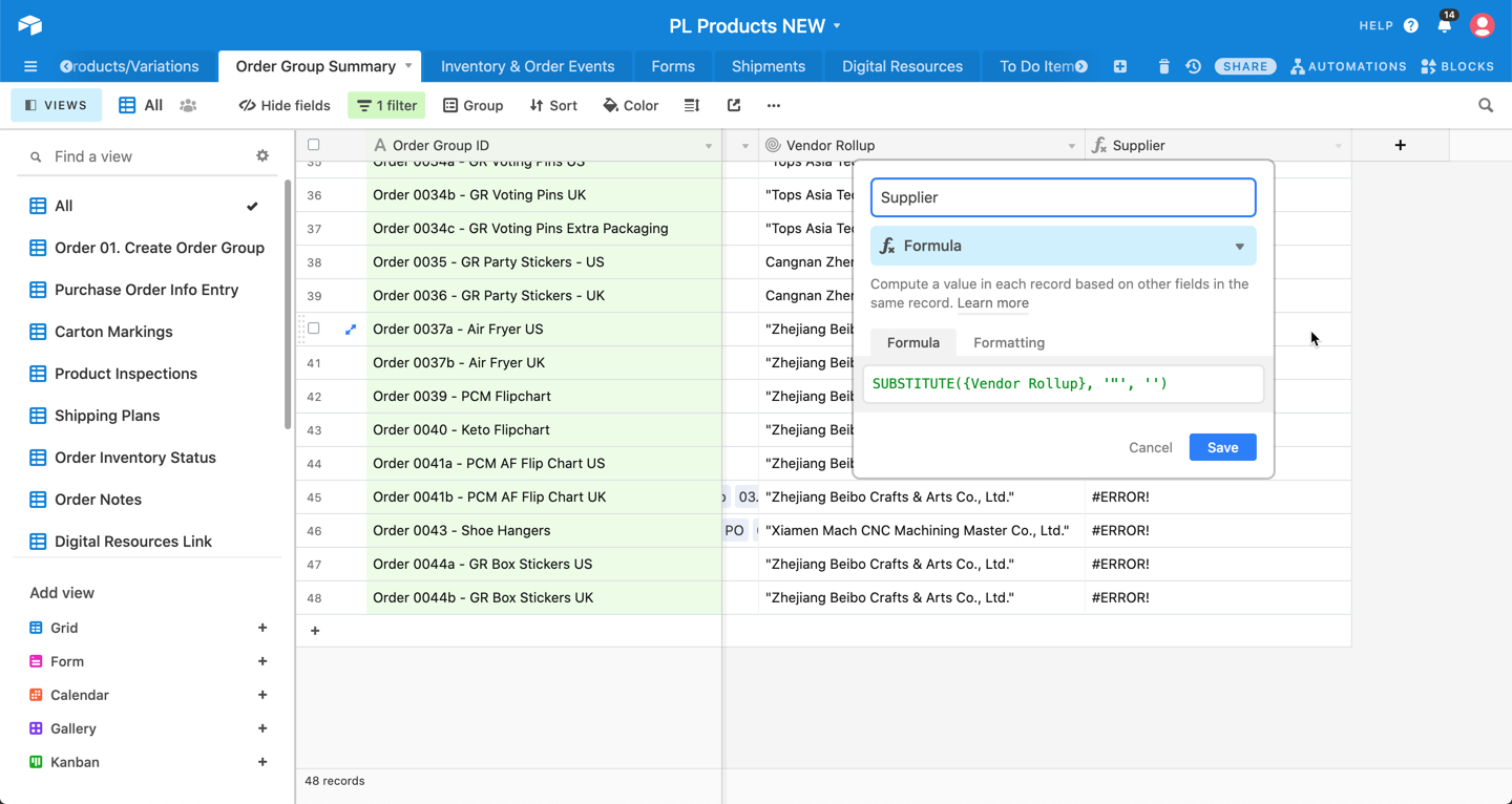

I have a rollup field (using ARRAYUNIQUE) that should always produce a single array value.
I want to pretty it up and remove the encompassing quotation marks, but I can’t seem to figure it out.
I’ve tried all of the following formulas, but none of them seem to work.
SUBSTITUTE({Vendor Rollup}, '"', '')
SUBSTITUTE({Vendor Rollup}, '/"', '')
SUBSTITUTE({Vendor Rollup}, """, "")
SUBSTITUTE({Vendor Rollup}, "/"", "")
Can anyone help me shed some light on my issue?
There’s a chance your rollup is coming in as array. You can turn it into a string by adjusting your formula like so:
SUBSTITUTE({Vendor Rollup}&"", '"', '')

That worked! Thank you so much.
But why did it work (if you’d be so kind to explain)?
Kamille_Parks11
Forum|alt.badge.img+27
adding &"" to the end of a Rollup turns it into a string (text as opposed to an array), and SUBSTITUTE() can only work with text/numbers and not arrays. You could also accomplish all this from within the Rollup itself and do away with your formula by doing something like:
SUBSTITUTE(ARRAYUNIQUE(values)&"", '"', '')
or
SUBSTITUTE(ARRAYJOIN(ARRAYUNIQUE(values)), '"', '')
