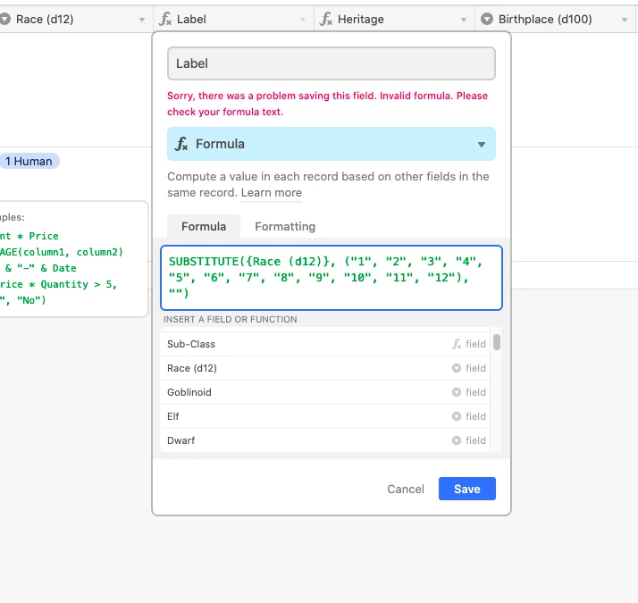

I’m working on a character generator for Dungeons and Dragons and I’m having trouble building a formula to get all the information in one place.

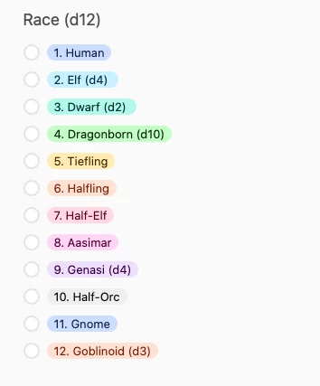

This is the view on the form I created:
My goal is to create a formula that get rid of the numbers and just displays what Race the player selected (elf, dragonborn, etc.) for easier readability in grid view.

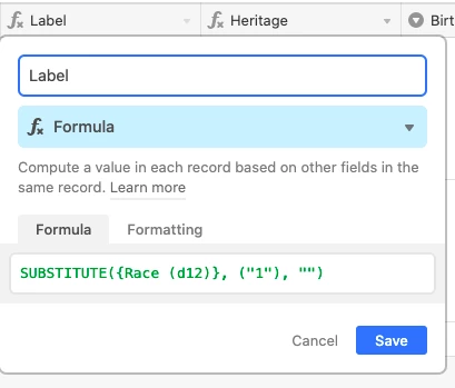

When I write the formula to only refer to a single number it works fine.
But when I try and have the formula substitute multiple numbers with a blank space it returns an error message.
I was using the example formula on the side as a reference which uses => instead of a comma to separate the value being substituted with the new value but that didn’t make a difference. I’m pretty sure I copied the format of the example correctly otherwise so I’m not sure what I’m doing well.
I have no experience programming, I’m just teaching myself as I go along so any help/advice would be extremely appreciated. Thank you!
  • August 10, 2021
Hi there! Try this:
REGEX_REPLACE({Race (d12)}, "\\d+\\.\\s", "")
This formula uses regular expressions to replace combination of number, period and empty space with a given string (in our case empty string “”).

Thanks Ela I tried it and it works!!!
