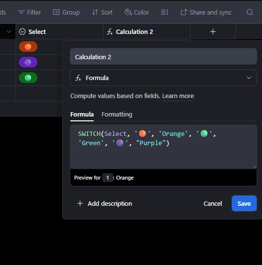

The color picked for a single select isn’t attached to the string value, so outside of the actual field Airtable is going to read everything as blank (this is also honestly bad for data integrity).
You’re going to need to add something to the single select for this to work, but depending on how many options you’re utilizing, there may be a useful workaround. What about using colored circle emojis to fill the string value? You need to add a Switch function to translate them (or I suppose you could work directly with them in your formula) but I just tested this and it worked 🤷‍♂️

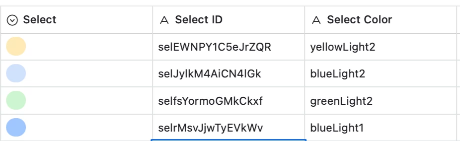

Hi ​@Yves56,
I agree with ​@DisraeliGears01, using empty or even spaces for the single select bubbles is not an idea solution, but I will assume that you have a very good reason for keeping that set up so I will entertain this approach.
My recommendation is to use a script to get the color and or the option ID of the single select. You can use these these values to create a mapping formula that will do something based on the actual selected single select bubble.

This is how it looks on the table:
You can make the script as an automation script so that it will run anytime your single select is updated. Hope this helps! Also if you want to share more about your use case we might be able to recommend other options that won’t need this workaround.
