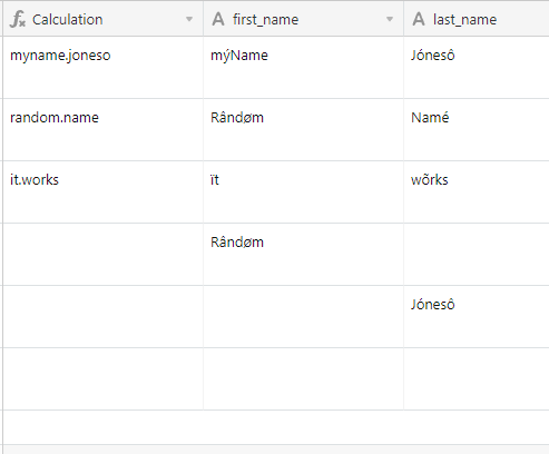

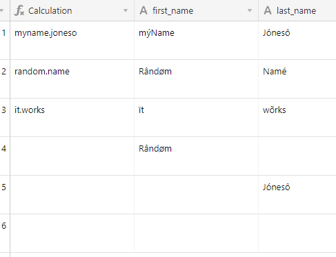

Hey @courtneydean!
Give this formula a shot:
IF( AND( {first_name}, {last_name} ), IF( REGEX_MATCH( TRIM({first_name}) & TRIM({last_name}), "[á,à,â,å,æ,ç,è,é,ë,ê,î,ï,ì,ñ,ô,ö,ò,ø,õ,ù,û,ü,ý,í,ú,ş,ó]" ), REGEX_REPLACE( REGEX_REPLACE( REGEX_REPLACE( REGEX_REPLACE( REGEX_REPLACE( REGEX_REPLACE( REGEX_REPLACE( REGEX_REPLACE( REGEX_REPLACE( REGEX_REPLACE( REGEX_REPLACE( REGEX_REPLACE( REGEX_REPLACE( TRIM(LOWER({first_name})) & "." & TRIM(LOWER({last_name})), "ó", "o" ), "ş", "s" ), "ú", "u" ), "í", "i" ), "ý", "y" ), "[ù,û,ü]", "u" ), "[ô,ö,ò,ø,õ]", "o" ), "ñ", "n" ), "[î,ï,ì]", "i" ), "[è,é,ë,ê]", "e" ), "ç", "c" ), "æ", "ae" ), "[á,à,â,å]", "a" ), TRIM(LOWER({first_name} & "." & {last_name})) ) )
Here's what the formula looks like in Airtable:
Ben_Young1
Forum|alt.badge.img+22
Hey @courtneydean!
For some reason, every time I try to post a reply with the formula body text that I wrote, the post kinda just disappears.
I've just tossed the formula I created into a gist that can be accessed here.
Here's a look at what the formula looks like in Airtable:
I'm happy to answer any questions you might have about the formula or help with any additional adjustments if you're curious.
