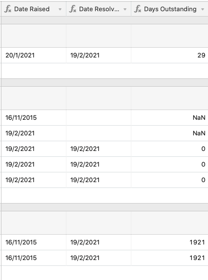

I have a table to show the duration of certain tickets that are received for problems. I have a Date Raised field, Date Resolved field, and a Days Outstanding field.
I want the Days Outstanding to return the difference between Date Raised and Date Resolved when there is a value in the Date Resolved field, and I want it return the difference between Date Raised and TODAY() when the Date Resolved field is empty.

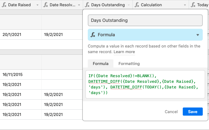

I’m currently using this formula:
IF({Date Resolved}!=BLANK(), DATETIME_DIFF({Date Resolved},{Date Raised}, ‘days’), DATETIME_DIFF(TODAY(),{Date Raised}, ‘days’))
It’s working fine when Date Resolved is populated, but returns NaN when it’s empty.
I have created another field just to check that the today-date resolved formula works and it’s returning exactly what I want, it just doesn’t work when it’s inside the IF formula

Best answer by augmented
Hey Alex, try taking out the !=BLANK() and just say IF({Date Resolved}, …
  • February 19, 2021
  • February 19, 2021
Worked! Thanks my friend!
As a side note, this could also be simplified a little by putting the IF() function inside a single DATETIME_DIFF():
DATETIME_DIFF(IF({Date Resolved}, {Date Resolved}, TODAY()), {Date Raised}, 'days')
