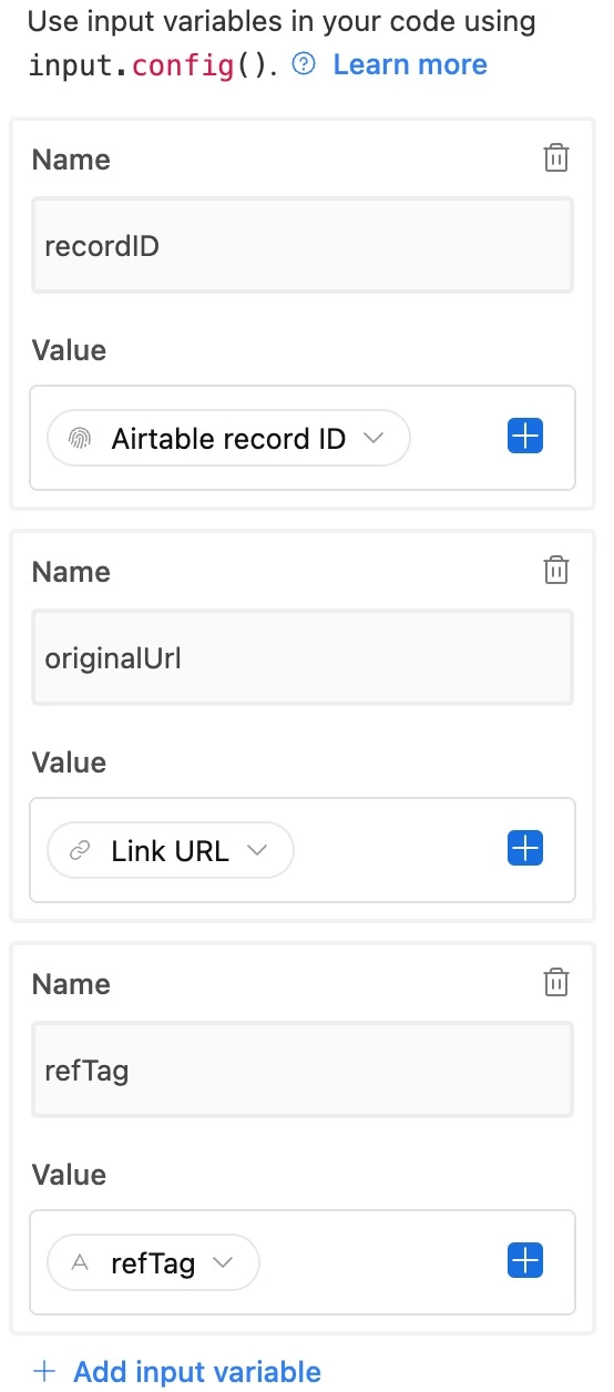

@Arthur_Tutt I'm not sure if it's user error on my part but I'm getting the following error:
ERROR TypeError: Cannot read properties of undefined (reading 'startsWith') at cleanUrl on line 10 at main on line 81
Arthur_Tutt
@airballer86 can you paste in your entire script? I'm guessing some variable didn't get updated properly converting from my setup to yours. And also take a screenshot of how you setup your input variables (in the left panel)
airballer86
  • November 6, 2023
@Arthur_Tutt here you go:
var urlTable = base.getTable("Link Checker") var inputConfig = input.config(); var recordID = inputConfig.recordID; var originalURL = inputConfig.originalURL; var refTag = inputConfig.refTag; function cleanUrl(linkUrl, reftag) { // Add missing 'https://' or 'http://' if (!linkUrl.startsWith('http')) { linkUrl = 'https://' + linkUrl; } // Add missing 's' in 'http://' linkUrl = linkUrl.replace('http://', 'https://'); // Remove invalid characters linkUrl = linkUrl.replace(/[\'§]/g, ''); // Split the linkUrl by '&' const parts1 = linkUrl.split('?'); console.log(parts1) if (parts1[1] == null) { let cleanedUrlComplete = parts1[0].toString() if (refTag != null) { if (!cleanedUrlComplete.includes('?')) { cleanedUrlComplete += `?ref_=${reftag}`; } else { cleanedUrlComplete += `&ref_=${reftag}`; } } return cleanedUrlComplete; } if (parts1[1] != null) { const parts2 = parts1[1].split('&'); console.log(parts2) // Filter out parameters starting with 'ref_=' or 'ref=' const cleanedParts1 = [parts1[0]].filter(part => !/^ref(_|=)/.test(part)); console.log(cleanedParts1) const cleanedParts2 = parts2.filter(part => !/^ref(_|=)/.test(part)); console.log(cleanedParts2) let cleanedUrl2 = cleanedParts2.join('&'); console.log(cleanedUrl2) // Join fields based on logic let cleanedUrl1 = cleanedParts1.toString() console.log(cleanedUrl1) let cleanedUrl2Question; if (cleanedParts2.length == 0) { cleanedUrl2Question = cleanedUrl2 console.log(cleanedUrl2Question) } else { cleanedUrl2Question = `?${cleanedUrl2}` console.log(cleanedUrl2Question) } let cleanedUrlComplete = cleanedUrl1 + cleanedUrl2Question console.log(cleanedUrlComplete) if (refTag != null) { if (!cleanedUrlComplete.includes('?')) { cleanedUrlComplete += `?ref_=${reftag}`; } else { cleanedUrlComplete += `&ref_=${reftag}`; } } return cleanedUrlComplete; } } // Example usage // const linkUrl = 'example.com/page?param=value&ref_=123&other=456'; // const reftag = '456'; const cleanedUrl = cleanUrl(originalURL, refTag); console.log(cleanedUrl); // Output Cleaned URL var updates = [{ "id": recordID, fields: { "Cleaned URL": cleanedUrl } }] // console.log(updates) await urlTable.updateRecordsAsync(updates);
and a screen shot of the variables
Arthur_Tutt
@airballer86 Couple ideas to try
https://www.loom.com/share/58320af793454079999b5ed14a2e3704
If that's still not working can you screenshot your table? Need to check all field names got converted properly

@Arthur_Tutt It's working now! User error on my part; I did not capitalize the RL in the variable name originalURL. Thank you so much for your solution, and introducing me to Loom! I do wish there was a way to give your solution a SuperKudos!
