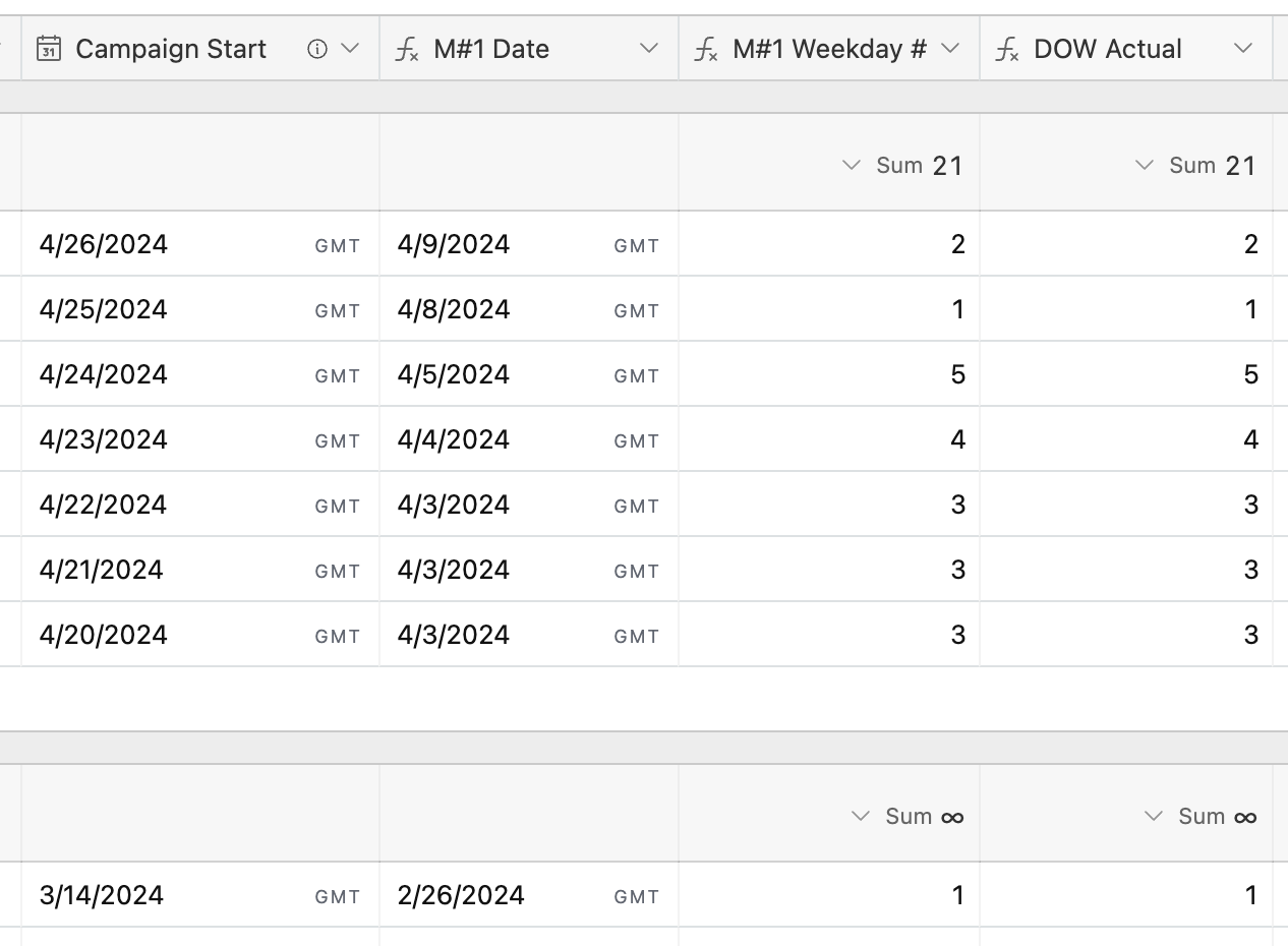

  • Milestone #1 (M#1 Date) should be -13 weekdays before the Campaign launch.
  • M#1 Weekday # shows the correct day of week the M#1 Date should be, but M#1 Date is obviously not right (4/7 is a Sunday, which should be 0 not 1).
  • When I reverse look up the M#1 Date using a WEEKDAY({M#1 Date}), the formula returns the correct day of week the M#1 Day should be, but not what referenced date actually is.
    • So if you look at 4/2, the WEEKDAY() should be 2 (based on how Airtable has Sunday=0 and Saturday=6), but that formula returns 3

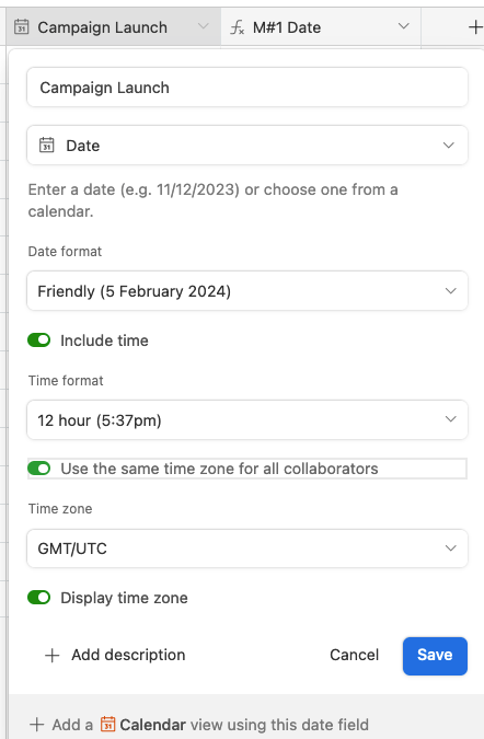

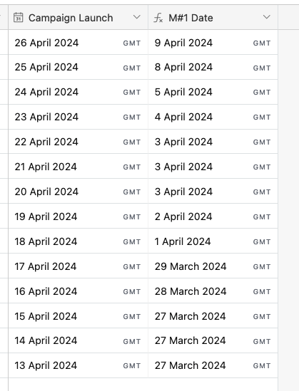

Could you turn on the timezone display for both of the date fields to see whether there might be an issue there maybe?
  • February 4, 2024
It's definitely a time zone issue. I checked and turned it all on to GMT and now it shows the correct days. Thank you! Was losing my mind.
I guess my next question is there a way to set the Timezone for a Date field? I've looked in to this before and only see it possible to change on Formula fields.
Ah, to do that you'll need to turn on "Include time" for your date field:
You'll then get the option to set the timezone for that date field
