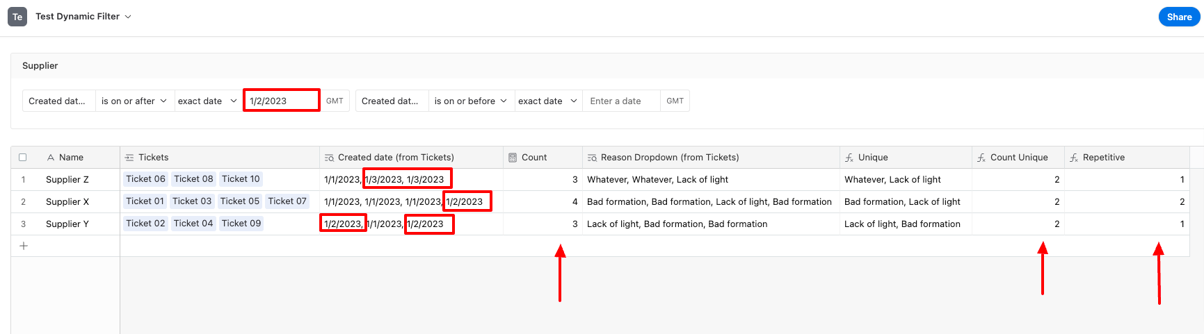

I'd like to create some sort of dynamic filter that when I input a date, everything else in this table will update accordingly. The link records that won't meet the filter criteria will be excluded, therefore, updating the COUNT calculation and all related formulas.
To give you more context about the base setup, there are two tables:
  • Tickets
  • Suppliers

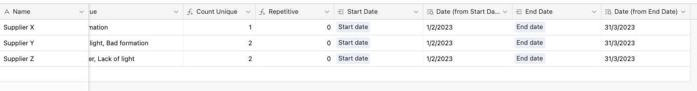

What you see in the screenshot above is the Suppliers table, which is aggregating all the tickets.
Is there a way to exclude linked records based on a filter?
Thanks everyone!

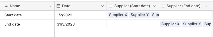

  1. Create a separate table with Name, Date and 2 link records to one of the tables
  2. You will need to bring the lookup values from those two records on the desired table
  3. Do the same in the other tables if they're linked - bring the lookup value of the Start Date and the End Date of your interval.

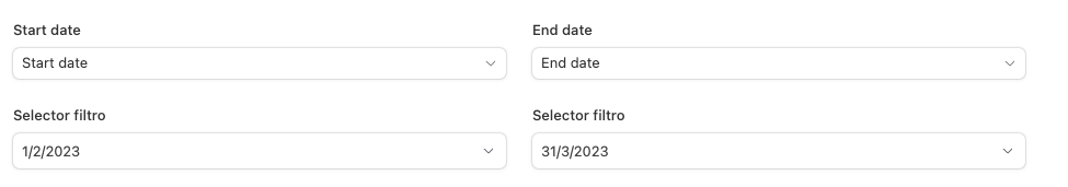

  5. Then use the record Picker in an Interface and link it to it's specific element Date
