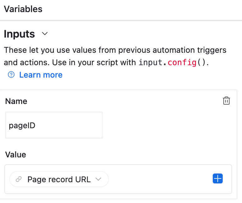

  • Add an input:
  • Then import it into the script:
let inputConfig = input.config();
  • and then use it later:
let recordUrl = `${inputConfig.pageID}`; // URL to open the record in an Interface
This works perfectly. It opens the correct record in the correct interface even on an iPhone.

  • Add an input:
