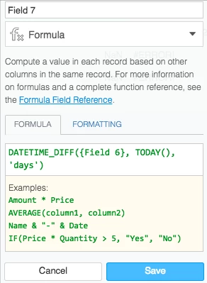

Additional problem - I now want to work out how many days until the expiry date, but because the formula does not return a date format, I can’t use FROMNOW. I feel like DATETIME_PARSE might help but I can’t quite work out how to do it. Anyone have any ideas?
Hi @Catherine_Robson
I think you are overthinking this (understandably) - it turns out that the Datetime_Diff() function works with it’s parameters being formula fields displaying dates…
Field 6 is a formula - and here’s the result:
Hope this helps,
Julian
You are right - I was totally overthinking it - easy to do once you go down the rabbit hole :slightly_smiling_face: Thanks, this works perfectly!
